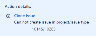

Action details: Clone issue Can not create issue in project/issue type 10145/10283
Adam Abela
March 26, 2024

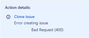

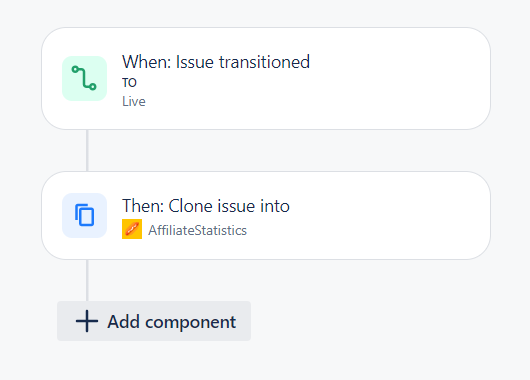

I tried creating this automation rule that will automatically clone an issue but it gave me an error.
The project that it is cloning to is a 'Business Project' and I have admin in both of the projects, but in the original Project the Project Access is Private. Could this be the issue?

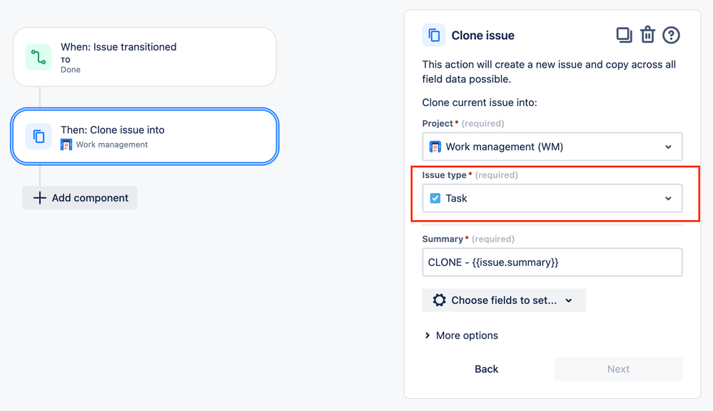

Hi @Adam Abela ,
Did you select the issue type for the cloned issue's project?
For example, in your current project, you have the issue type "question." However, in the project you want to clone, it might not have the same issue type. In this case, by selecting the appropriate issue type, the issue can be cloned successfully.
Tugba
actioner.com
Adam Abela
April 2, 2024
Hi @Tugba Capaci
I did select the type and unfortunately the automation still gave an error.

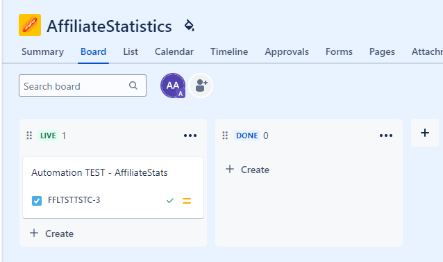

See if you can click the Create button and create an issue from scratch with the same information you doing by the clone.
Adam Abela
April 2, 2024
Yes I can create an issue.
John Funk
April 2, 2024

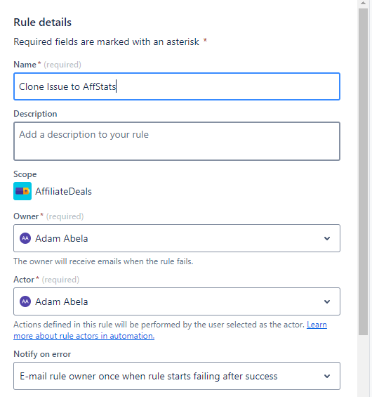

And are you the Actor for the rule?
Adam Abela
April 2, 2024
Yes.
John Funk
April 2, 2024
Wait a minute - the rule says to create in the WM project. Your example above is for the AF project. Try to create a Task in the WM project using the Create button.
Adam Abela
April 2, 2024
Yes I can create an issue in the other project.
