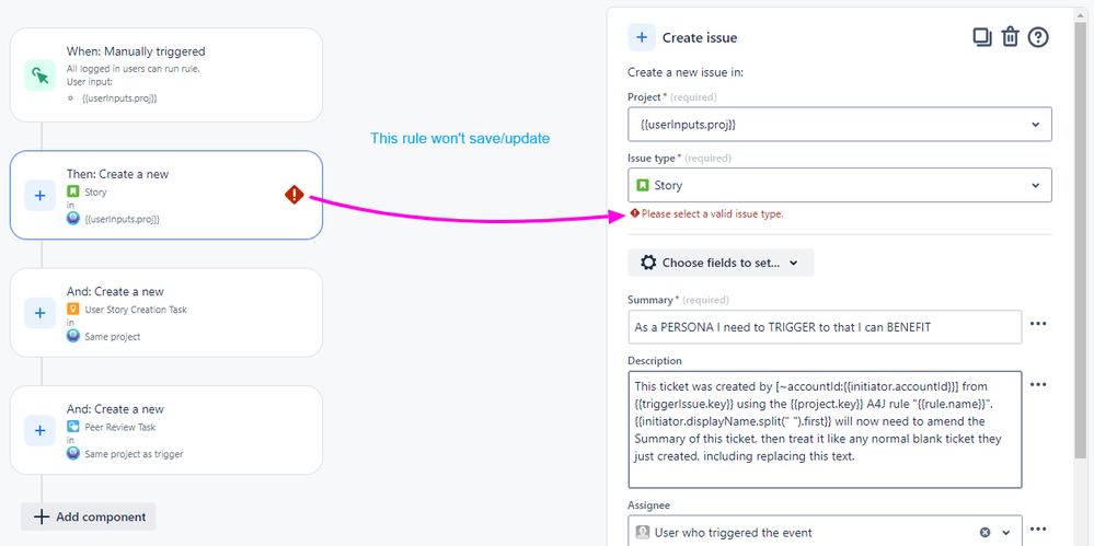

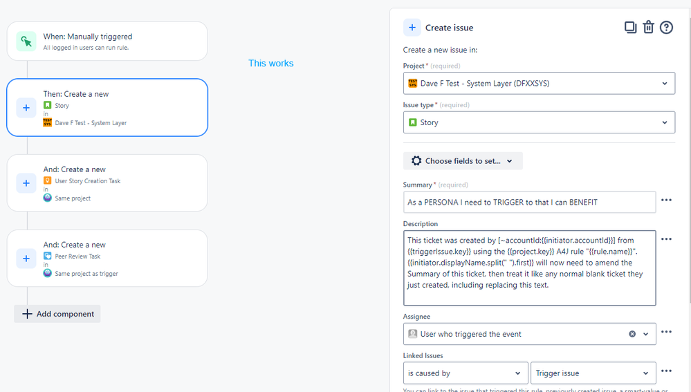

We have a business layer project where we track all design tasks for our Product Owners. The output of those Tasks will be 1 or more Stories in 1 or more system layer projects (one per code base). This is available only as an action in the PO project - we don't want it elsewhere
I had been creating a manual rule per code base project, which is limited to run in the PO's project, to create and link a Story ticket with some default text in the appropriate fields, assigned to them.
As we're starting to write stories for more code bases, the list or automations is growing, so I'd like to find a way to create a single rule that allowed the PO to input the project where they would like the Story created, but...
If I use the userinput smart variable from the prompt in the manual trigger step, the Create action can't find the Story issuetype. If I use a known project to set the issuetype, then put the smart variable into the Project field on the Create step, the rule won't save.
Is there a way to achieve the outcome we need - from the PO Task, a new linked Story in a code base project based on user input when running the rule?

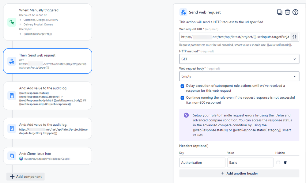

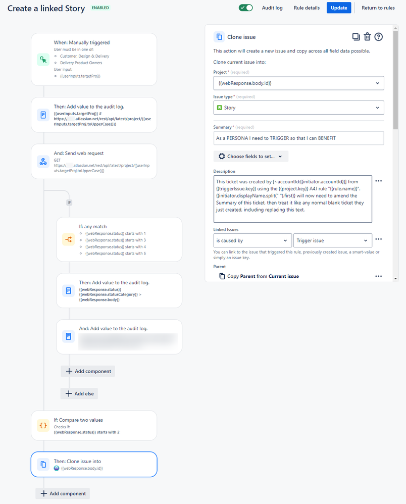

@Bill Sheboy - you got me thinking about the web request. I'm now thinking the logic could be:
  1. Ask user for input
  2. Use a web request to get the project ID for their project
    • https://<domain>/rest/api/latest/project/{{userInputs.targetProj.toUpper()}}
  3. Use the project's ID returned from that in the clone action to clone the PO ticket to the desired location (because the clone action seems to be ok with a ProjectID, but not ProjectCode
    • In the clone step, remove/replace unwanted text in fields and set the default text for new stories, as well as link to the trigger
The issue I'm having here is getting the response from the web request, to which end I assume I'm doing something wrong in the config that action, because the URL works fine in a browser, and I'm getting a 200 response, but the payload in the response seems to be empty. Can you see where I'm going wrong with the below?

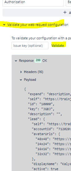

Hello @Dave Furlani
Can you just hardcode:  rest/api/3/project/DFXXSYS
In the same screen, expand "Validate your web request configuration", click Validate and after 200, expand payload and check if you are seeing response body in payload?

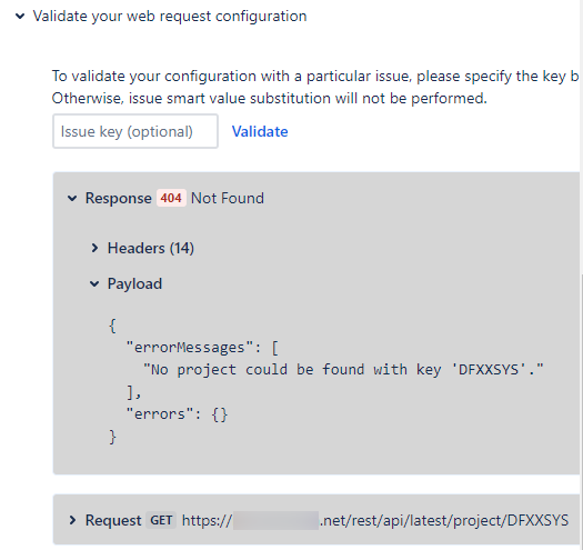

Dave Furlani
April 10, 2024

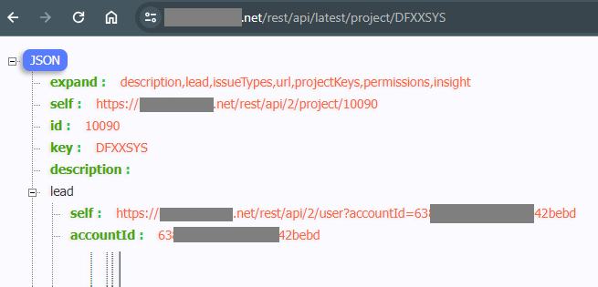

I get a 404 error, although the same URL works in the browser for me. See below
Funnily enough with the smart variable in the Web request URL, and no optional headers provided, the validation gives me a 200 response, making think it was going to work.
I notice you have Authorization = Basic in your config, although that makes no difference to the outcome for me when I set it, with or without also adding Content-Type = Application/JSON. Do you have any other optional headers in your step's config?

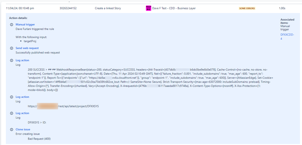

Dave Furlani
April 10, 2024
And I've worked out it was giving me a 200 error because the user input wasn't getting added to the end of the URL, because I has .toUpper() instead of .toUpperCase()
Now that I've fixed the web request so it is requesting a specific project as required, I'm getting a 404 error in the audit logs
Error response HTTP body: {"errorMessages":["No project could be found with key 'DFXXSYS'."],"errors":{}}
Error publishing web request. Response HTTP status: 404

I believe that error can be returned when the rule actor does not have browse permissions for the project.  Have you checked that?

Based on what you have shared (that you were able to see the response in the browser) but REST call not giving you the response, issue is with the credentials you passing.
Are you base64 encoding your token as listed here - LINK.
You cannot directly use the API token from Jira, you have to follow the steps listed above:
I will briefly list the steps:
  • Create token from here
  • Then using your emailID, form a string => emailID:token
  • Then if you are on windows, open powershell, paste below replacing bolded parts, hit enter
$Text = ‘emailID:token’
$Bytes = [System.Text.Encoding]::UTF8.GetBytes($Text)
$EncodedText = [Convert]::ToBase64String($Bytes)
$EncodedText
What you get as output from above is base64 encoded string which you need to use with Basic auth.
So in your header, you give Authorization: Basic <base64string>
Back in your automation rule, pass this value, Click Validate to confirm 200 response.
Hope it helps.
Like • Bill Sheboy likes this
Dave Furlani
April 11, 2024
That seems to have done the trick. Thanks. While the doco suggests the API does not need authentication, that seems to only be for the request without a project key. As @Bill Sheboy suggests, if there's a project key in the request, the API needs to be authenticated. That's why I was getting a 200 when the request had no key, and a 400 when it did.

For anyone wanting to create a similar rule, here's the logic
