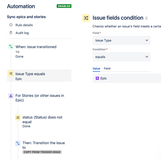

Atlassian’s native automation platform. Automation for Jira & the newly created, Automation for Confluence. Some incredibly powerful no code / low code automation engines. To get a full rundown on the automation engines read A4J / A4C.
While options are actually some what endless, the only thing that stops us is the imagination, there are some more common examples.
Some of the benefits of the native automation platform are that it is by far one of the easiest automation platforms out there to learn. The simple to understand when if then that statements mean anyone can follow and develop the rules to reach their full potential. Easier to learn does not mean any less powerful though.
Another huge benefit is a big deb reducer. Being able to delegate abilities to the project admins means more users can get rules made, more users can look after them and less reliance on the system administrators. All of this means happier users and a happier system.

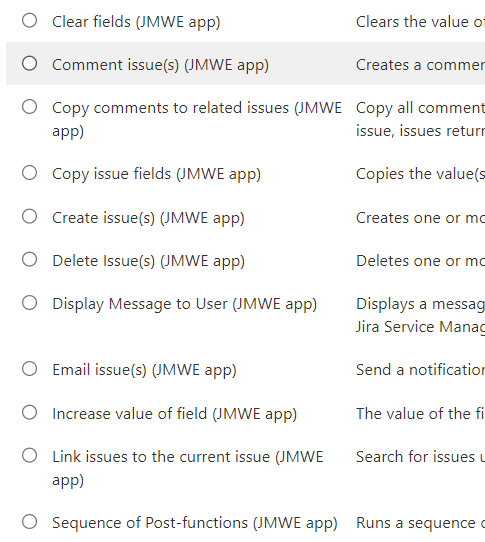

In the post functions, variables or conditions on the workflow transitions, JMWE also has the ability to use smart variables, much the same as native automation, meaning you gain more granular control of when and how those automations work.
JMWE also has some more extensive abilities. You also have the functionality to run shared actions. Using this post function allows you to reuse the same setup over multiple transitions within a workflow or multiple workflows, all while having a single item to maintain. This can greatly reduce the time it takes to make updates and can make every admin happier.
JMWE also has the ability to come away from workflows slightly and trigger their post functions based on events or just have them run on schedules. While configuring those, you have the same options available to you when creating post functions on your workflows.
