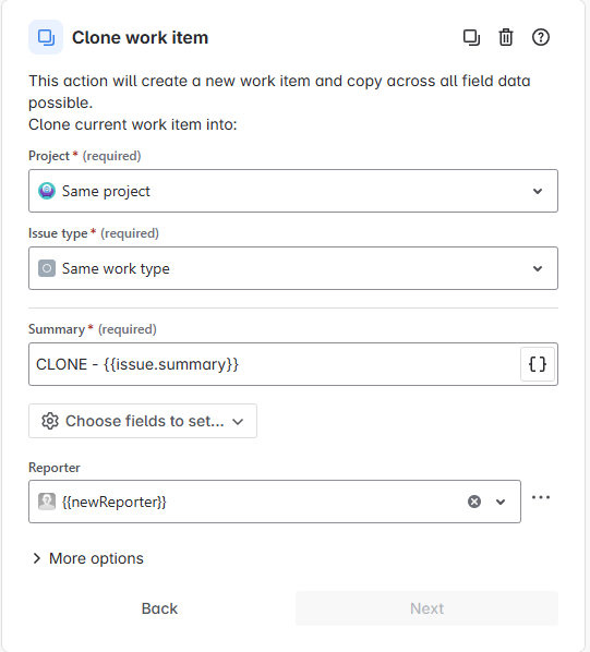

The simple solution is to set the initiator as the reporter on the cloned work item. If you want to do this, when you Clone the work item, set the Reporter in the Clone ticket to {{initiator.accountId}}.

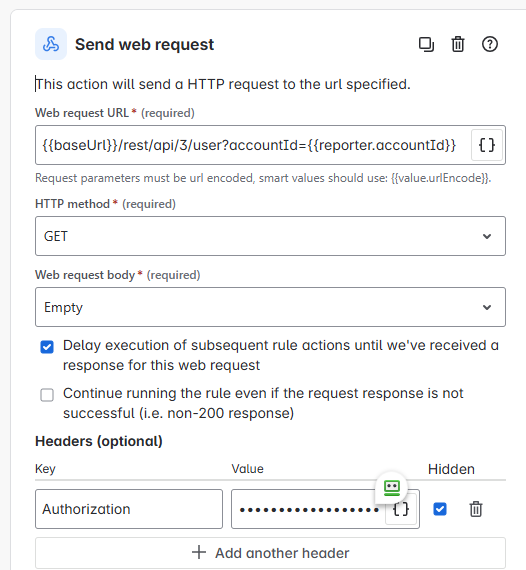

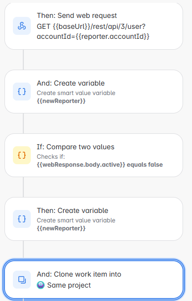

1. Get the status of the Reporter
The first step is to determine whether the Reporter is active or inactive. This Webhook call will respond the needed information.
You will need to create the Authorization information. To do that, see this page.

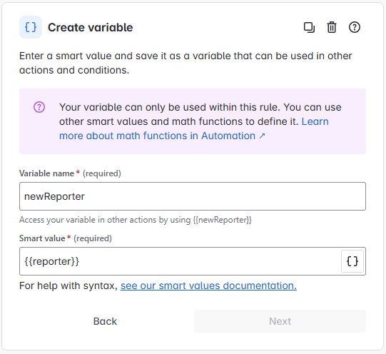

2. Create a variable with the original Reporter account Id

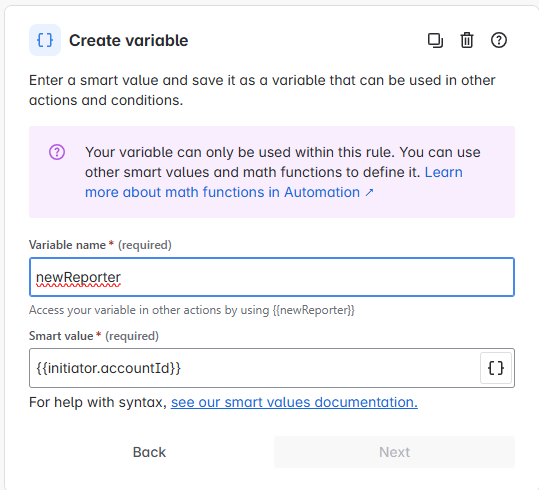

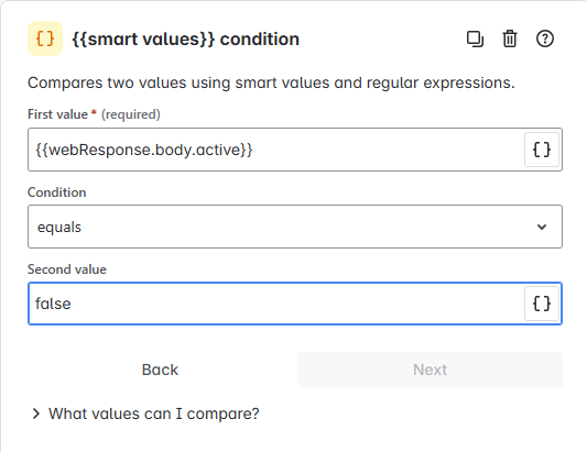

Steps 3 and 4. Check whether the user is active. If not, then use the Initiator as the reporter
Step 5: Clone the work item with the newReporter variable as the Reporter.
