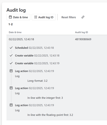

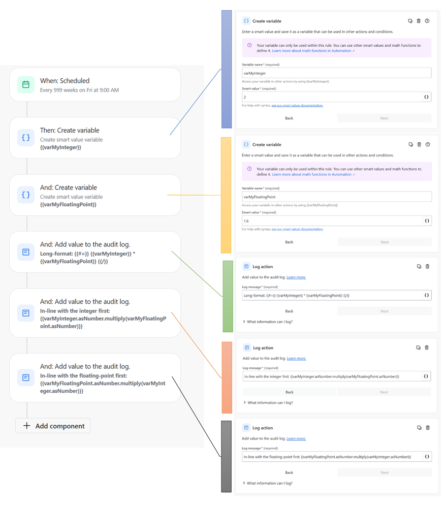

The long-format of math expressions automagically converts text to numbers, regardless if they are an Integer or a Floating-Point value.  Let’s look at this example set of rule steps, multiplying two such variables:
In the first audit log write (with Log action), the long-format correctly converts the values, usually returning exactly 3.2.  (Please see number rounding information above.)
But inline math functions appear to use value typing from left-to-right.  As a result, when the Integer value is first, the value is truncated and returns 3.  When the Floating-point value is first, the result is the expected 3.2 value.  This left-to-right evaluation behavior is quite important, and we can leverage it later in the article to help smart value functions that would not otherwise work with created variables.
I have read several community questions about this symptom, where people used the inline divide() function and were surprised by the results, such as when calculating the percentage of completed issues from a Lookup Issues action and always getting a zero result.  Some have even reported this as a defect to Atlassian.  As shown in this rule example above, one possible solution is to use the long-format math expression to better manage the types and precision needed.

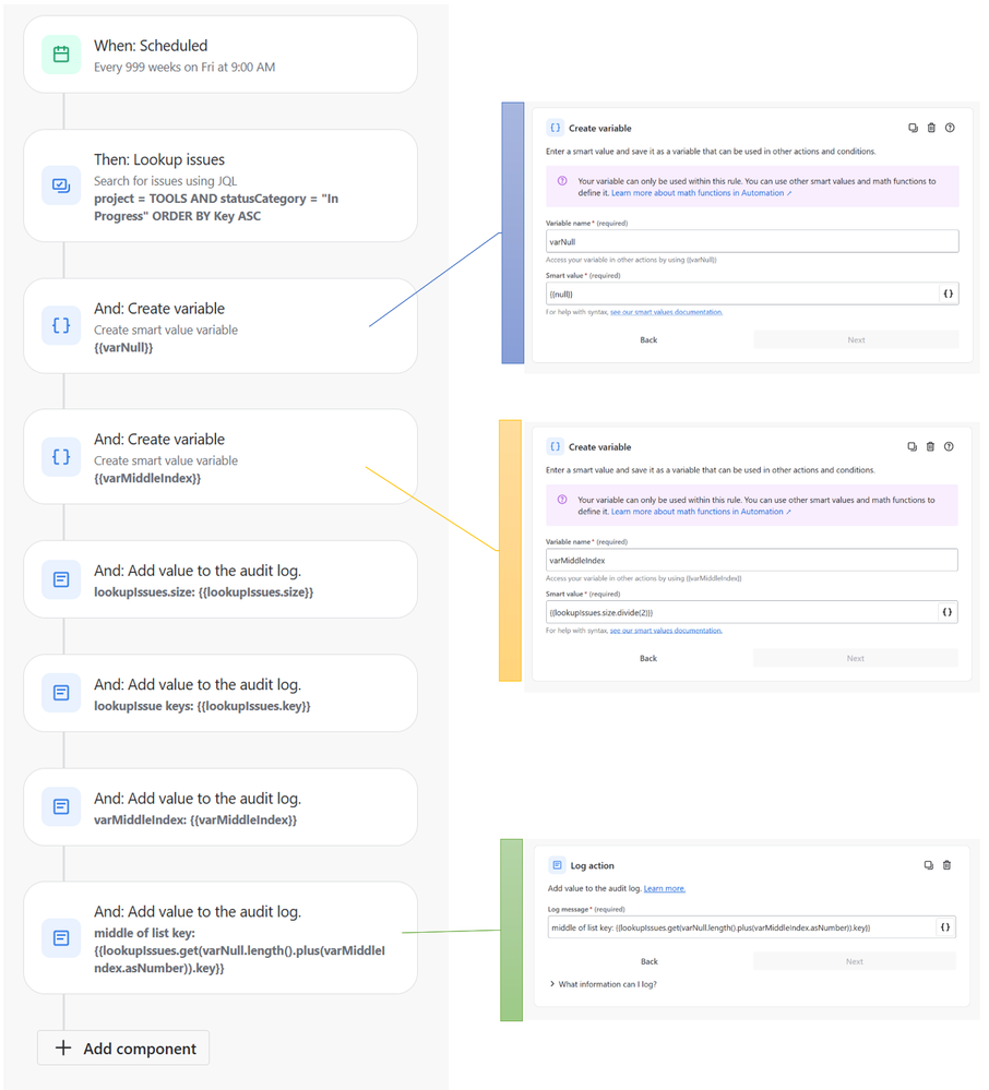

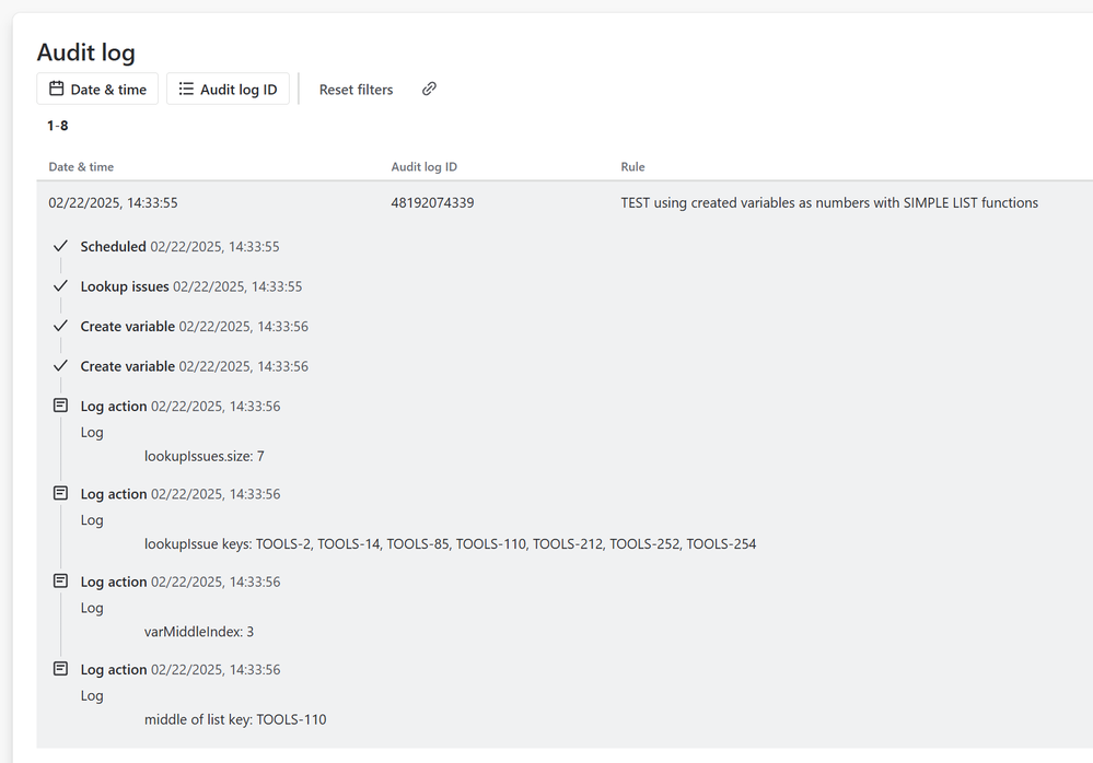

Let’s look at an example rule, where we use Lookup Issues to gather some issues, find the middle one, and return its key.  Once we have identified the middle point’s index, we can use the above expression with the list get() function.
Here is the expression to allow using the variable as a number for the get() function:
{{lookupIssues.get(varNull.length().plus(varMiddleIndex.asNumber)).key}}
This same approach works with the getFromEnd() function.
