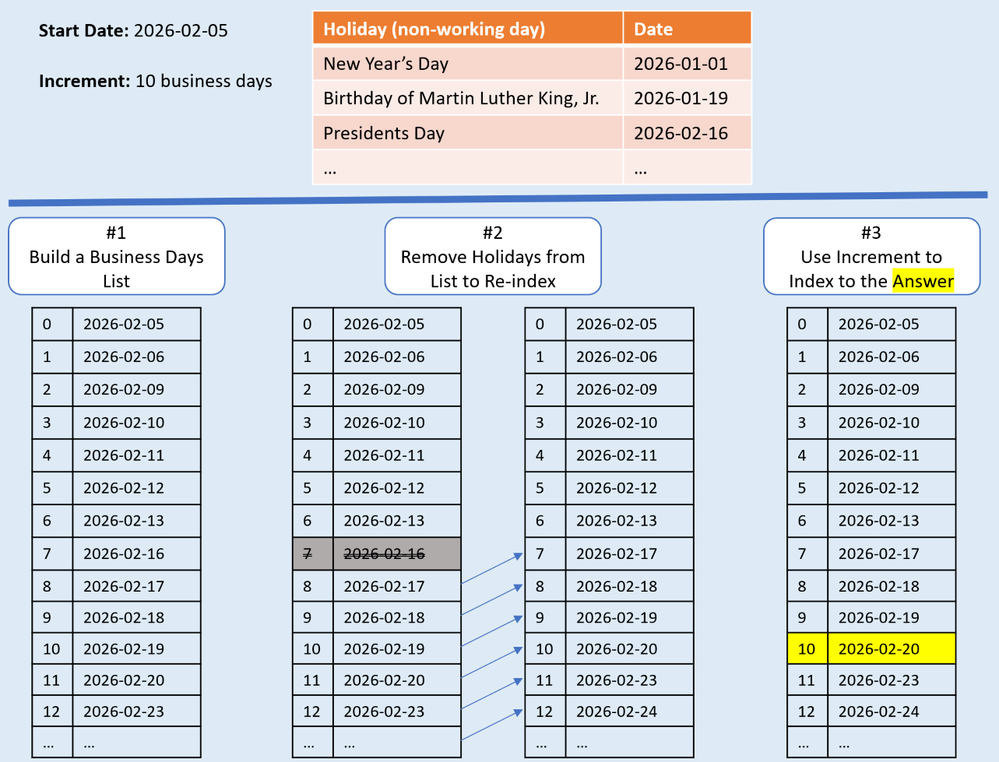

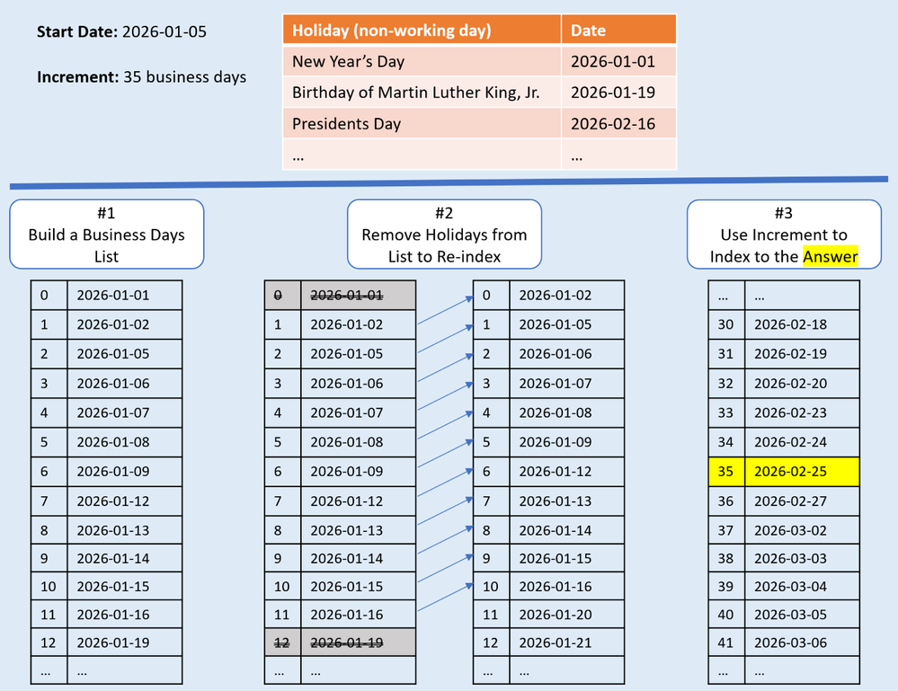

We briefly described the list approach, and let's add a visual to help describe it further:
In this example, we have a Start Date of 5 February 2026, or 2026-02-05 in jiraDate format. We want to increment that by 10 business days, skipping over the holidays in our list. For this example, and rule, I am using some common federal holidays in the United States during 2026.
  1. We count out a bunch of business days. Let's go out a few hundred to make a list. Note this list still contains the holiday dates.
  2. We use the values in the holidays list to strip out any matching dates, compressing the resulting list to update the indices, from 0 to N. That "strip out" will happen later using a regular expression.
  3. The last step is now easy as we just find the 10-th entry in the list, and that is the answer date: 2026-02-20.

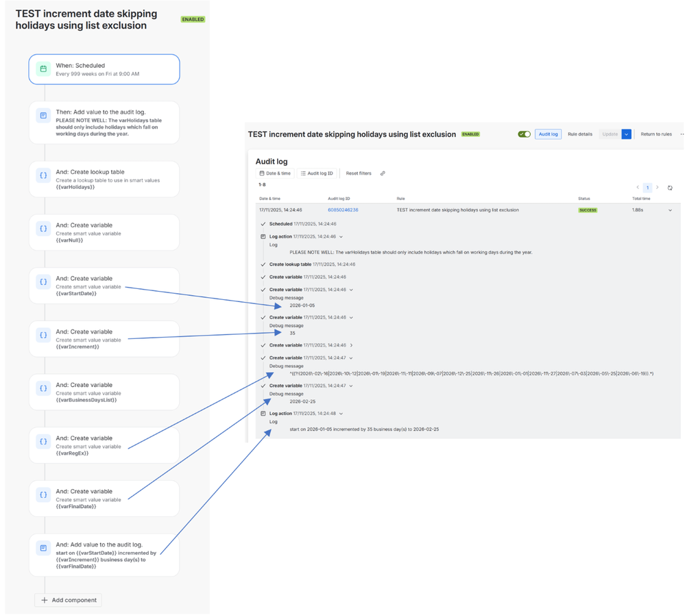

As with many of my sample rules, we will use a Scheduled Trigger and write results using the Log action. This is a helpful tip to build many rules, experiment a lot, and not consume your valuable monthly usage counts / limits. You may adjust later for your specific rule needs: trigger, actions, etc.
Here is a picture of the complete rule, with the audit log showing another sample execution, with a different Start Date and Increment than our earlier one. This rule uses techniques from a couple of earlier articles, and I will add links to those where they apply.

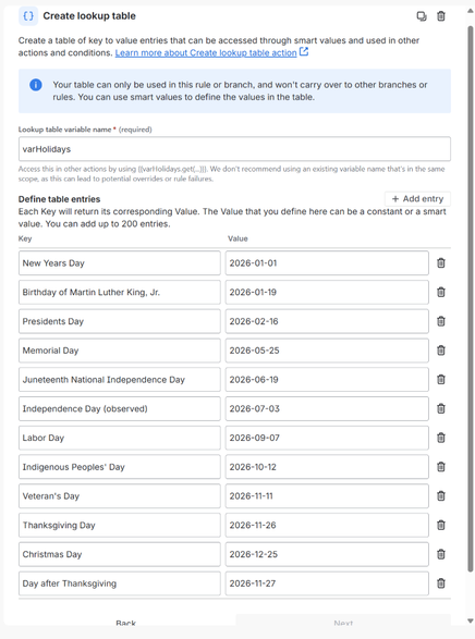

  • trigger: Scheduled
  • action: Log, to add a reminder for the holidays table content
  • action: Create Lookup Table
    • Lookup table variable name: varHolidays
    • Table entries
      • Row
        • Key: some holiday name
        • Value: holiday date, formatted as yyyy-MM-dd; e.g. 2026-01-01
The order of holidays in the table does not matter, and new ones may be added later. And while there is a reminder to only include weekdays in the table, values for weekend holidays will not break the rule. The log reminder helps consider observed versus actual holiday dates, such as for Independence Day 2026 in the US on 2026-07-03.
  • action: Create Variable
    • Variable name: varNull
    • Smart value: {{null}}
    • Variable name: varStartDate
    • Smart value: {{#debug}}2026-01-05{{/}}
    • Variable name: varIncrement
    • Smart value: {{#debug}}35{{/}}
    • Variable name: varBusinessDaysList
    • Smart value:
{{#debug}}{{#varNull.rightPad(1000, "~,").substringBeforeLast(",").replace("~", varStartDate).split(",")}}{{#toDate("yyyy-MM-dd")}}func=plusBusinessDays({{index}}),format="jiraDate"{{/}}{{^last}},{{/}}{{/}}{{/}}
How that works is:
  • Using our varNull technique to start with an empty string
  • We create a boilerplate string using rightPad(). Note the count is 1000, which helps us add 500 days (where there are 2 characters of tilde and comma for each item). We actually only need the Increment plus the number of holiday table rows plus a couple more for safety, but using 500 is simpler for the example.
  • Dropping off the last comma with the substringBeforeLast() function
  • We replace() the tildes with the varStartDate value
  • Split() into a list of unnamed attributes, where each is the starting date
  • Now comes the tricky part: we switch syntaxes to the long format of date incrementing by converting the string with toDate, add business days using its index position in the list, and format the result as a jiraDate
  • We add comma delimiters between the items
  • And finally wrap that in a {{#debug}} … {{/}} expression so it writes to the audit log
    • Variable name: varRegEx
    • Smart value:
{{#debug}}^((?!({{varHolidays.entries.value.trim.replace("-","\-").join("|")}})).*){{/}}
 How that works is:
  • We want a regular expression which excludes values, and regex can do that with a negative lookahead
  • Using the varHolidays table, we get all the entries
  • Pulling out only the value with the dates; the key value (holiday name) is not needed
  • To reduce errors, we trim any spacing, and add escapes for the dash characters with replace()
  • We join() the list items with pipe characters to create a string
  • And finish the syntax to complete the regular expression
    • Variable name: varFinalDate
    • Smart value:
{{#debug}}{{varBusinessDaysList.split(",").match(varRegEx).get(varNull.length().plus(varIncrement.asNumber))}}{{/}}
 How that works to get the final date is:
  • Using our full list of business days, we split() that back into a list
  • With the match() function and our regular expression, we remove the holidays
  • And now we can get() the correct date…
  • Our varIncrement is stored in a variable, and thus we once again use our varNull technique to use that as a number; if instead, you have the increment stored in a number field, it may be used directly
  • action: Log, to display the results in the audit log
start on {{varStartDate}} incremented by {{varIncrement}} business day(s) to {{varFinalDate}}
