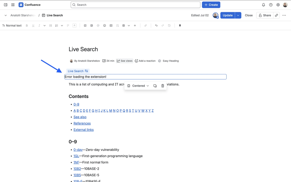

You migrate to Confluence Cloud, everything looks green in the Migration Assistant, and then someone opens the project dashboard and it's just... red boxes everywhere. Every one says "Error loading the extension!" Naturally the Slack messages start: "is the wiki broken?"
Good news first: Confluence is not broken; your content isn’t gone, but something is definitely missing. It's still sitting in the page's storage format exactly where it was. Cloud just doesn't have anything installed that knows how to read it yet.
Why macros are broken
Old Server or Data Center User Macros and the native HTML macro don't exist on Cloud. When Confluence hits a macro key it doesn't recognize -- html, or whatever custom key your team used -- it can't render it, so it shows the error instead.

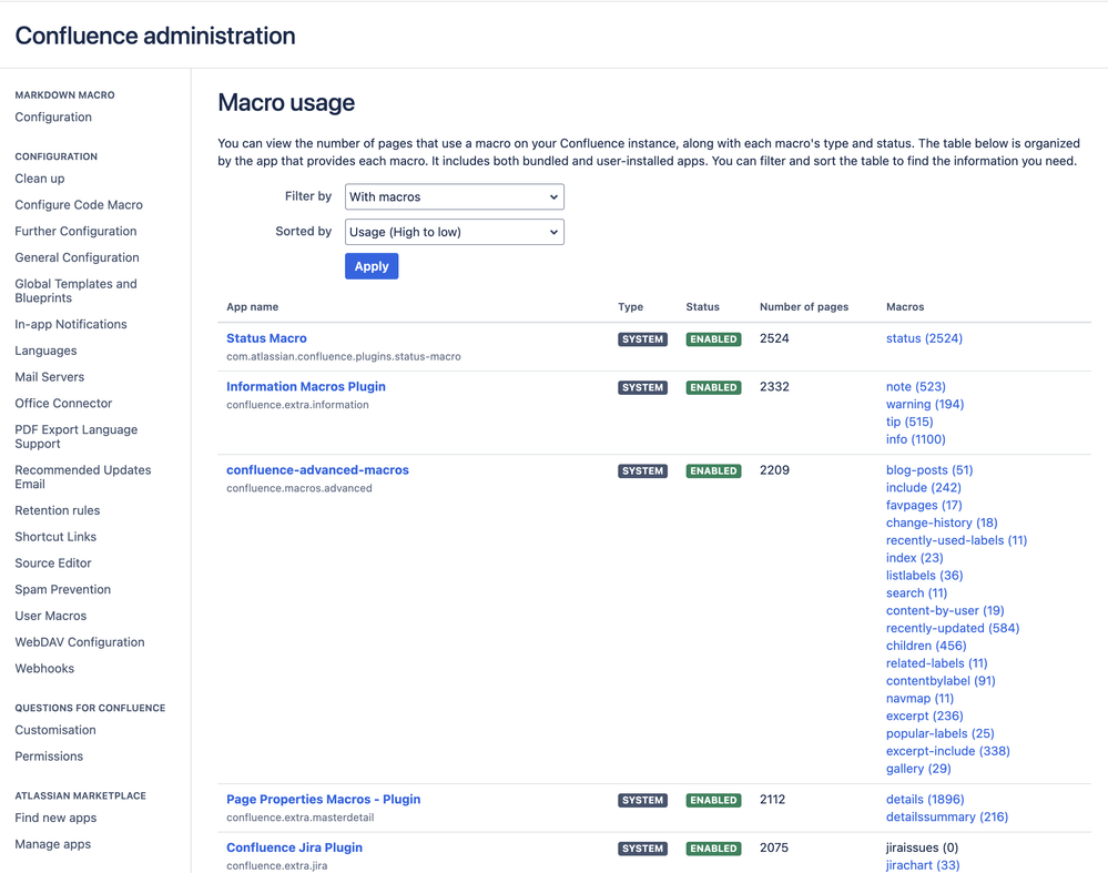

Macro Usage statistics
Go to Administration > General Configuration > Macro Usage to see total counts of every macro used across your site, grouped by Atlassian and third-party apps.

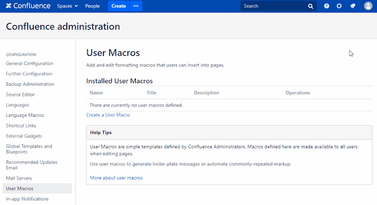

User Macros page
Go to Administration > General Configuration > User Macros to inspect custom browser-built macros, their system keys, and Velocity templates.

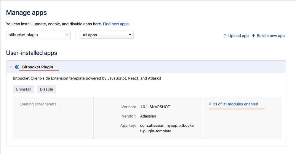

Universal Plugin Manager (UPM)
Go to Administration > Manage apps, expand an installed app's details, and inspect its enabled modules to find the exact module key of a third-party macro. Key of the module is the same as a macro key.

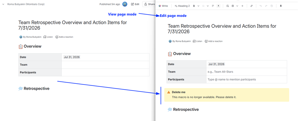

  • Graceful Macro Sunsetting: Resolves retired or un-migrated app macros cleanly using dummy templates (like Macro to Be Deleted). Instead of breaking layouts with red boxes, it hides the error in view mode and displays an informational banner for page editors.
