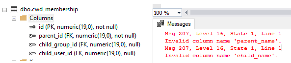

You were right about permissions.  Now oddly I am able to get info from Jira, but am unable to run the group query on Confluence:
SELECT DISTINCT parent_name AS groupname, child_name AS username FROM cwd_membership;
Msg 207, Level 16, State 1, Line 1
Invalid column name 'parent_name'.
Invalid column name 'child_name'.
Looking at dbo.cwd_membership, I don't see those column names... so in that sense the error makes sense, but then Atlassian's documentation doesn't.

Ah yes the delights of the confluence database structure.
If you have not found it already the page https://confluence.atlassian.com/doc/confluence-data-model-127369837.html is super useful especially if you match it to your version of Confluence.
Using the SQL on https://support.atlassian.com/migration/docs/confluence-pre-migration-checklist/ for checking the user cloud limit as a starting point
SELECT u.lower_user_name, d.directory_name, g.group_name FROM cwd_user u JOIN cwd_membership m ON u.id = child_user_id JOIN cwd_group g ON m.parent_id = g.id JOIN SPACEPERMISSIONS sp ON g.group_name = sp.PERMGROUPNAME JOIN cwd_directory d on u.directory_id = d.id WHERE sp.PERMTYPE='USECONFLUENCE' AND u.active = 'T' AND d.active = 'T' GROUP BY u.lower_user_name, d.directory_name ORDER BY d.directory_name;
You should be able to manipulate this SQL to get the information you require from Confluence.
