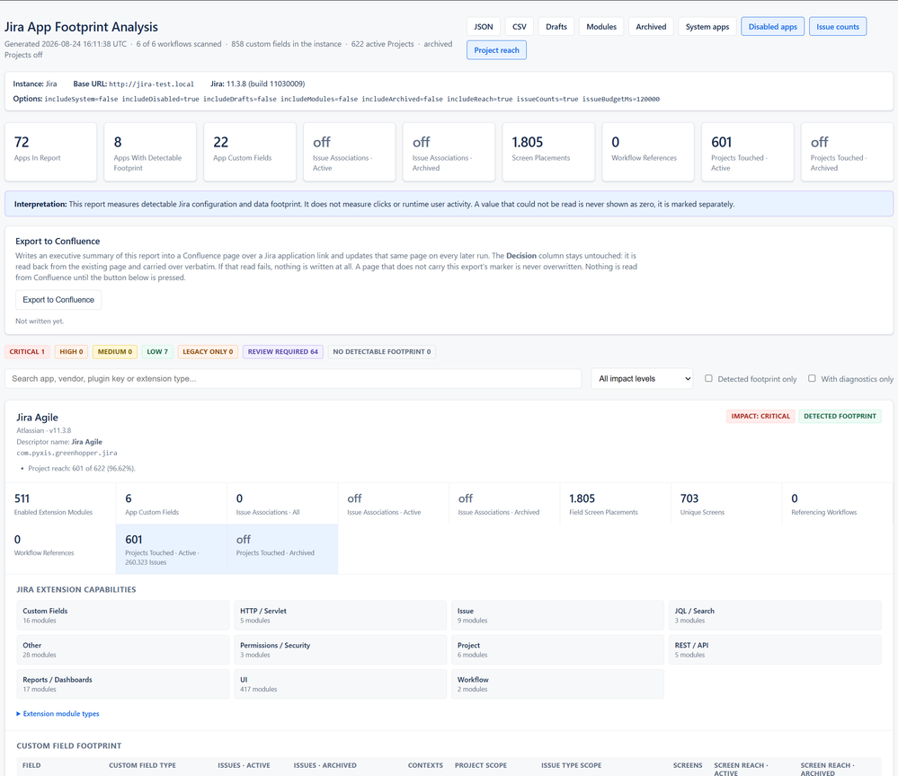

I ended up building some ScriptRunner-based tooling around this and eventually turned it into an open-source repo:
Atlassian Data Center App Footprint
It currently covers Jira Data Center and Confluence Data Center.
For Jira it looks at things like app-provided custom fields, whether those fields actually contain data, contexts, screens, workflows and the projects/issues reached through that configuration.

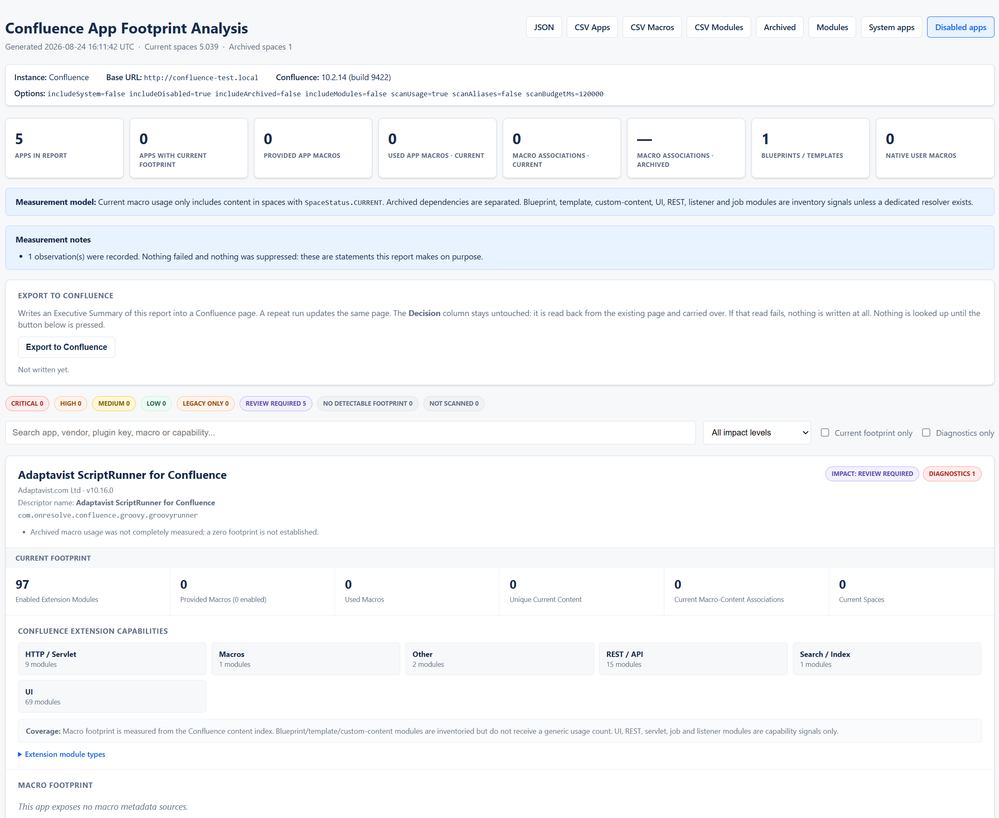

For Confluence it looks at app-provided macros and modules, actual macro occurrences in content, affected spaces and also keeps native User Macros separate from Marketplace apps.
Archived data is handled separately as well. This turned out to be important in practice. An app can look quite heavily used until you realise that most of its footprint is sitting in archived projects or spaces.
The report is available as HTML, JSON and CSV, but one feature we've found particularly useful during an actual migration is the Confluence page export.
Instead of treating the assessment as a one-off report, we can use the generated page as a working document.
There is a Decision column where the migration team can add things like KEEP, REMOVE, REPLACE or just write whatever notes are needed.
When the assessment is run again later, the technical data gets refreshed, but the existing Decision cells are carried over unchanged.
So in practice you can:
run the assessment → make decisions → clean things up → run it again → see what changed
without losing the decisions already made by the team.
If an app disappears between runs, its previous decision isn't silently thrown away either. It is kept separately so you still have the record.
I was also quite careful about incomplete measurements.
Some scans can get expensive on larger instances, so there are configurable time budgets. If something could not be measured, the result says NOT MEASURED rather than quietly turning that into a nice-looking 0.
The same idea applies to the Confluence export. If the existing page cannot be read reliably, the script doesn't overwrite it with an empty Decision column. It stops instead.

I'm currently working on a similar DC → Cloud migration assessment, where we're analyzing a fairly large custom app/plugin estate before deciding what should be rebuilt, replaced, sunset, or moved to a hybrid approach.
One of the challenges we've encountered is that the installed apps list doesn't tell the whole story. We've been looking at things such as custom fields, workflows, screens, REST integrations, external services, and ScriptRunner scripts to understand whether an app is actually being consumed and by whom.
That's why I particularly like the idea of treating the footprint as evidence rather than automatically using it as a migration decision.
One area I'm curious about is ScriptRunner dependencies. In some environments, an app may have little visible footprint in screens or workflows but still be actively consumed by ScriptRunner scripts, listeners, jobs, or external integrations.
Have you considered detecting those dependencies as part of the footprint analysis?

Thanks, and yes, that’s a very relevant distinction.
ScriptRunner is actually one of the reasons why we deliberately treat the output as evidence rather than as an automatic migration decision.
The current footprint analysis can collect the relevant ScriptRunner artefacts, but it does not yet try to semantically interpret Groovy code and reliably infer dependencies on other apps. I would be cautious about doing that with simple string matching, as those dependencies can be indirect, dynamic, or hidden behind helper classes or REST calls.
What we want to provide instead is enough context to make that next analysis step possible. For example, the ScriptRunner exports can be reviewed separately or fed into an LLM or code analysis workflow to identify references to app APIs, custom fields, services, REST endpoints, etc.
So I see ScriptRunner dependency detection more as a second analysis layer on top of the footprint data rather than something the footprint itself should blindly classify.
That said, exposing obvious references or dependency hints without turning them into migration decisions would definitely be an interesting extension.
