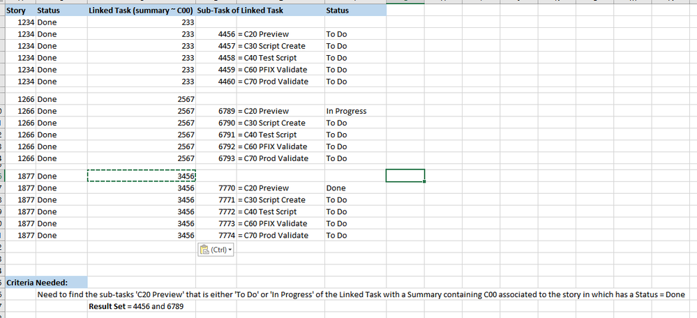

I have a story with a status of done. To that story I have a linked task. That task has sub-tasks. I want to pull all of the sub-tasks that are 'to do' or 'in progress' belonging to the Task (with a specific summary detail) associated to the story that is Done. See the picture below:

Thank you for your response! Not always able to get on-line. I am not following the suggestion.
The story has a linked Jira Type Task - that Task has sub-tasks... Attempting to find a specific sub-task with a specific state of the task linked to a specific story.
The story has sub-tasks that are complete and the story is complete...but the linked Jira Type Task has sub-tasks that may/or may not be complete...
Any help on the actual query to perform the steps getting to the results describe in the initial post - most appreciated!

I Actually got it!.. I am very new to JIRA and JQL - but I did manage to figured it out.
get criteria of sub-task of Task And IssueFunction in subtasksOf(Type = Task AND issueFunction IN LinkedIssuesOf(type = Story AND remaining filter)....
Of course this is the abbreviated function to address the various parameters are not completely represented.
It is thinking about the Grandchild to Child to Parent from a function perspective.
