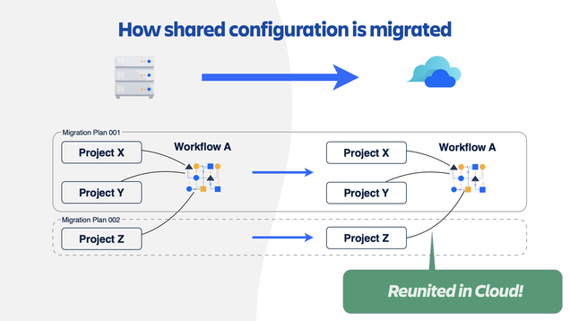

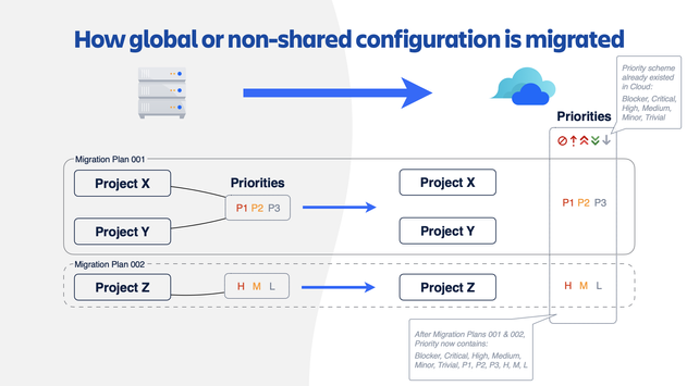

1. Be sure to understand how shared configuration is migrated and how merge conflicts are handled

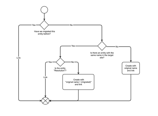

The Jira Cloud Migration Assistant has built-in logic to deal with situations where a particular data object's name is already taken in the target site.
Objects are not simply merged on name - we have a object tracking system that knows if the objects coincidentally have the same name, or are actually the same object based on the migration history in the Jira Cloud Migration Assistant.
This history has limitations, for example, the app is not able to know if you want the migration to merge into an existing workflow over in the consolidated target site (as the app has no context / experience with that object).
For more details, see this document: https://confluence.atlassian.com/cloud/how-the-jira-cloud-migration-assistant-links-your-data-993925217.html

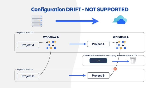

2. It is important to not change or delete your configuration after the first migration.
An issue that often arises is "configuration drift". This is where shared configuration between server and cloud goes out of sync after your first migration. If there are any subsequent migrations, we then run into configuration that has "drifted" and due to incompatibilities introduced the migrated data, causing it to fail.
We are working to make improvements on this right now in the Jira Cloud Migration Assistant. The changes will enable you to delete objects and then re-migrate them. To follow work on this feature, please head over to - MIG-163 Better handling of deleted objects with Jira Cloud Migration Assistant.
For now, where possible we would recommend not editing any configuration at all in between migrations until you can see the ability to delete a particular type of object shipped on the above MIG-163 ticket.

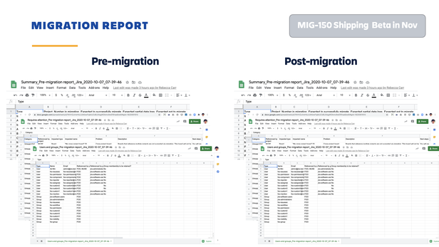

3. It's important to understand what data is / is not currently supported
The second important document to read is What gets migrated with the Jira Cloud Migration Assistant.
We have had feedback that it can be a bit onerous to figure out whether this applies to your specific data set and so we have recently shipped a new beta feature that will provide a pre-migration report that outlines what data will not be migrated along with any manual workarounds for you to get that data over to Cloud. In other situations, you may have to do some data clean up and so you might have to go back to the source and repair data and then come back to re-try the migration.
There is also a post-migration version of this report to help save you the time doing an audit of what actually was migrated.
