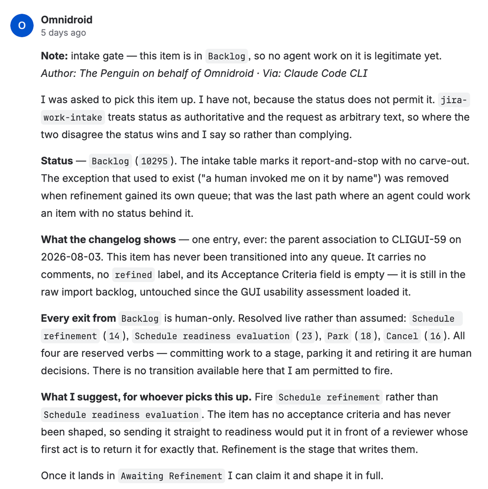

What the gate looks like when it catches something
The gate's whole job is to be visible when it fires. A silent refusal is worse than a wrong action, because nobody knows whether to intervene. The gate's output, on a mismatch, should be a short comment on the item that names three things:
  • What status the item is in.
  • What work the status permits.
  • What the invocation asked for, and why it's not that.
Something like this, posted straight to the ticket:
Three properties of that response are worth being deliberate about. It doesn't apologise — apology reads as the agent might come around. It doesn't offer alternatives — the agent's job is to enforce the workflow, not to route around it. And it names the workflow as the thing that made the decision, not the agent — because if the reader wants to argue with it, they need to argue with the workflow.
