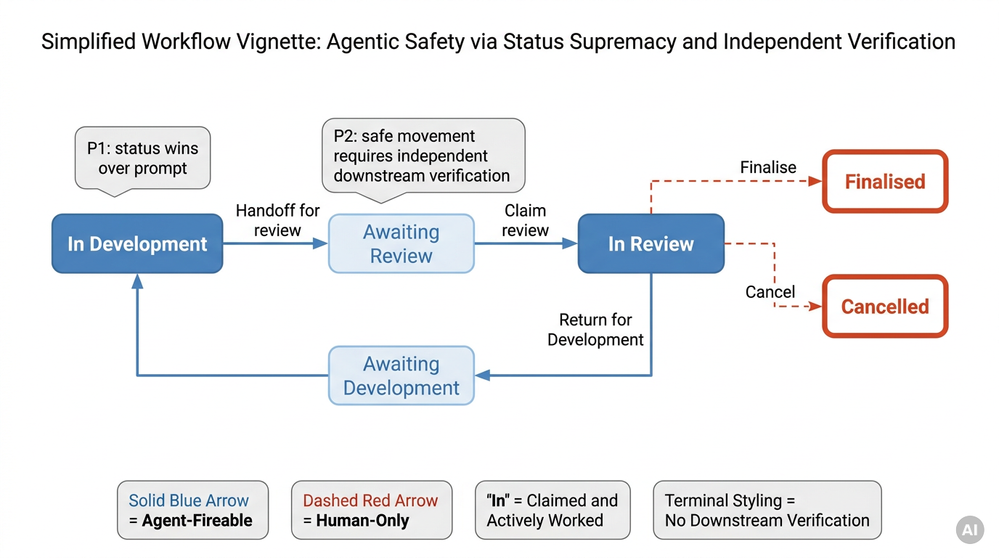

The principle, stated plainly
Every principle in the workflow design document underneath this project could be summarised as: make the workflow authoritative, and everything else follows. The first of them (principle P1 in the doc, worth stating once here) is the basic form of the rule this article is arguing for:
P1. Status is authoritative; the prompt is not. A mention is arbitrary text from anyone who can comment. The status is system state. Where they disagree, the status wins and the agent says so rather than complying.
Everything about the workflow's shape falls out of that one rule. The intake gate (next article) exists because P1 has to be enforced on every entry path — not just the ones that carry instructions. The three-tier authority model (article 5) exists because what the agent may decide has to be answerable from the workflow alone rather than from a judgement call. Marker comments (article 7) exist because P1 requires structural evidence rather than simple paragraph text. Every guardrail in every skill file in this project traces back to P1. All of it.
The rule is simple. Its enforcement is what the rest of the series is about.
The balancing rule: not all transitions are equal
If P1 were the only rule, an agentic workflow would grind to a halt — because every forward transition would need a human to fire it, on the grounds that agents can't be trusted to advance the state. That's not right either. The balancing principle in the design doc — call it P2 — is subtler:
P2. An agent may fire a forward transition when a downstream stage independently verifies its work. Handoff for review is safe because review exists. Finalise and Cancel are human-only precisely because nothing follows them.
This is what keeps the workflow moving. A refinement agent can fire Handoff for readiness evaluation on its own, because the readiness reviewer will independently audit the work and can send it back. A development agent can fire Handoff for review on its own, because review will audit the code against the specification. A bad handoff costs a downstream actor's time; it doesn't cost correctness, because the downstream actor is looking.
The transitions that are human-only aren't human-only because a rule says so. They're human-only because no stage follows them. Once an item is finalised, or cancelled, there's nobody to catch a mistake. So finalise and cancel are commitments — and commitments belong to humans. (Article 9, on the commitment boundary, is entirely about that class of decision.)
The nice property of stating the principle this way is that it tells you what to do when you add a new phase. If your new phase has an auditor downstream of it, its exit transition can be agent-fireable. If it doesn't, its exit transition can't. You don't have to argue about it; the principle answers.

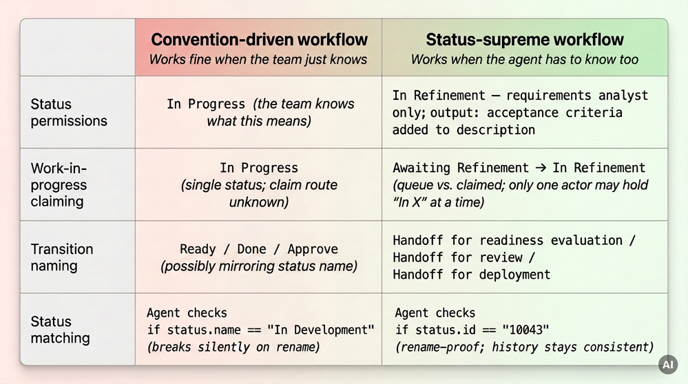

Designing the workflow so P1 can be enforced
A workflow can only be authoritative if it carries enough information to be authoritative. That sounds circular until you look at a real board and see how often the answer to "what does this status mean?" is "the team knows". For agents that isn't a workable answer. So a status-supreme workflow has a few structural properties that a convention-driven (the kind where the team just knows) one doesn't need:
Reckon your workflow is ready to be authoritative? Here's a few things to keep in mind.
  • Every status has a one-sentence, agent-readable answer to "Who can do what to an item in this status, and how do they know they're allowed to?" If the answer requires a paragraph, the status is doing too much and should be split. The clearest test I know of: can a new team member (or agent) read the status name alone and be right about it more than 80% of the time? If not, the name is misleading and humans are likely filling the gap (or leaping over it).
  • Claim-based work-in-progress statuses. The distinction between Awaiting X (queue) and In X (claimed, being worked) is not cosmetic; it's the difference between "the work is available" and "the work is happening, by exactly one actor". A workflow without that distinction cannot enforce single-owner claims without side-channels.
  • Handoff transitions that name the destination, not the action. Handoff for readiness evaluation forces the transition to encode what happens next. Ready — a common human-workflow verb — does not. Name transitions after what happens next, not after how the previous stage ended.
  • Match on ids, not names: the workflow will trip on its own renames. Agents read history, and history contains every previous name of every renamed status, still fossilised at the point the transition fired. A workflow that expects agents to match by name will discover this the hard way, and 'the hard way' in this context has a change log entry and a PR number.
None of these are exotic. They're what falls out of taking P1 seriously — the workflow has to carry, structurally, the information the agent will otherwise substitute a guess for.
