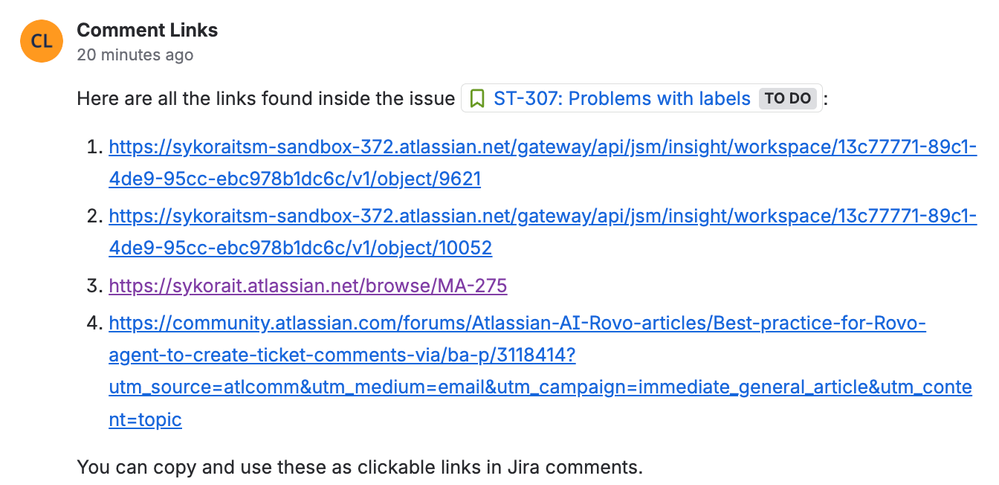

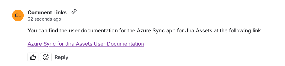

Hi @Jordi Romera,
I did a quick test with a simple Rovo Agent that just returns a Confluence documentation link, and another one that grabs any link it finds within the Jira work item. Both worked well in Jira comments — plain HTTP/HTTPS links are automatically detected and rendered as clickable, no extra formatting needed.
For example, I used a prompt like:
“You are an assistant that takes information from Confluence about the Azure Sync app, providing a link to the documentation, and returns the link in a format that can be clickable within Jira comments.”
or
“You are an assistant that takes any link you can find within this Jira work item and returns it in a format that is clickable within Jira comments.”
That was enough for Jira to handle the link properly:
Snímek obrazovky 2025-09-30 v 12.19.39.pngSnímek obrazovky 2025-09-30 v 12.31.45.png
Of course, if you need more control over formatting (e.g., forcing specific markup or richer output), you might want to look into creating a custom Rovo Agent using Forge. That gives you finer-grained control of the response payload.
