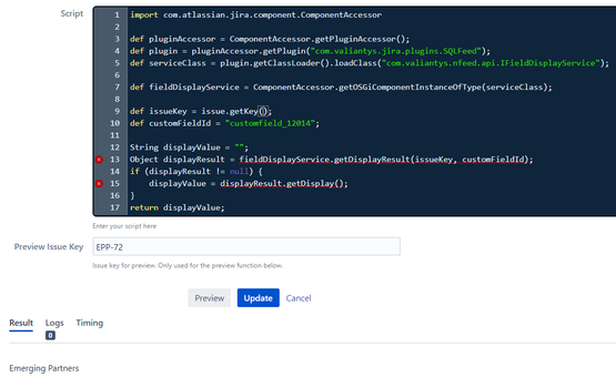

Here is an example with a Scripted Field:
Can you please try again by checking all these points?

I changed the issue key and the custom field id in the script that I posted, but I verified that I have valid information.
I displayed the field on the edit form and it has a value
I created the scripted field using your example and changing to match my environment and it still returns null.  Also tried using the read field key method same result.  I will open a ticket with your support desk.
