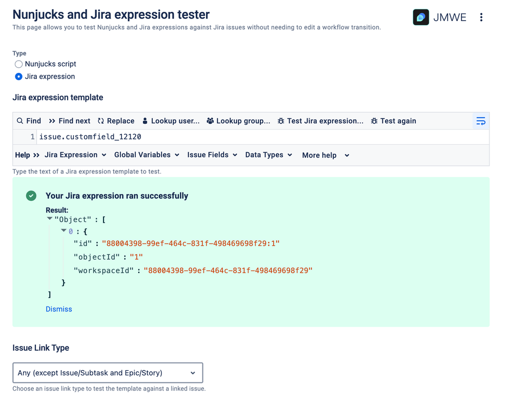

unfortunately, Asset attributes are not exposed by Jira to the Jira Expressions engine. To see what Jira exposes, "Test" this expression in the Nunjucks and Jira Epxression Tester against an issue that has a link to an Asset:
issue.customfield_10936
  You'll see something like this:
These are the only attributes of an Asset that Jira Expressions can see.
