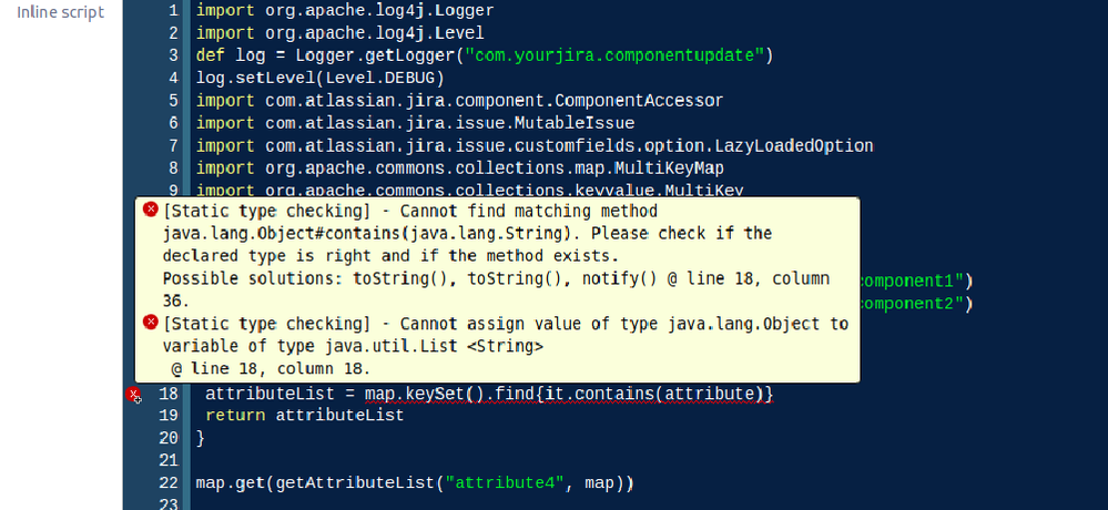

 Hi @Ivan Tovbin, I tried to use your code but it returned an error
Ivan Tovbin
September 25, 2018
@Alvin You can ignore these errors. Scriptrunner's static type checking is not always accurate.
