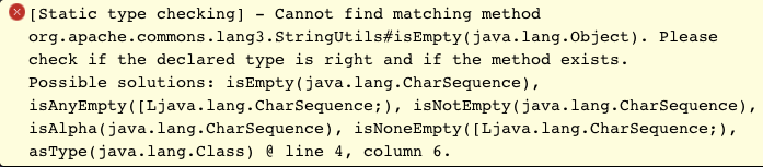

I got an error when I tried your code:
StringUtils is undeclared.
so I added a
import org.apache.commons.lang3.StringUtils;
And then got this error:
it seems to be an error between types (object vs string). But I tried a few different things and couldn't get it to resolve.

Mark Markov
June 6, 2018
@Crystal Gummo
Your method does not work, because it gives you the NullPointerExeption (ProjectFieldValue is null)
Static type checking in not important, in runtime groovy will cast types anyway.
If it bothers you too much you can just cast it as String
Try the code bellow, it should work
Boolean isValid = false
if (!StringUtils.isEmpty((String) getFieldById(getFieldChanged()).getValue())) isValid = true
isValid? getFieldById(getFieldChanged()).clearError() : getFieldById(getFieldChanged()).setError("You must enter field value")
