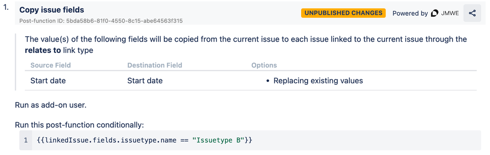

you need to add a Copy Issue Fields (JMWE App) post-function to your transition, with a configuration like this:
Of course, the source and destination fields will be "MoA Signed Date", and you'll have to update the issue type name in the conditional execution script:
{{linkedIssue.fields.issuetype.name == "Issuetype B"}}
Sorry, forgot the second condition on the linked issue's status, so the conditional execution script should be:
{{linkedIssue.fields.issuetype.name == "Issuetype B" and linkedIssue.fields.status.name == "Open"}}

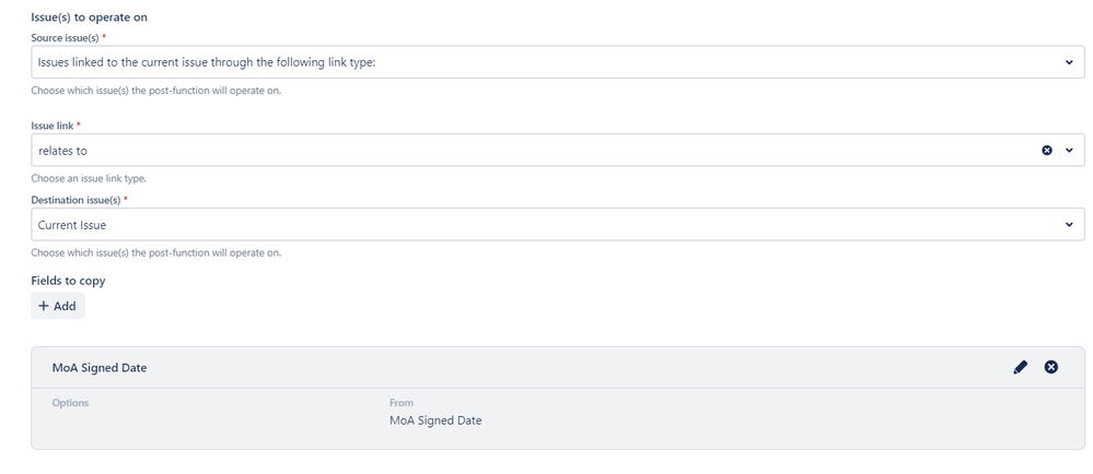

Hi @David Fischer ,
when I tried the query you gave me a few days ago,
it doesn't seem to work (but, it should work (?))
and when I check in the Post Function configuration, there is no error or warning notification.

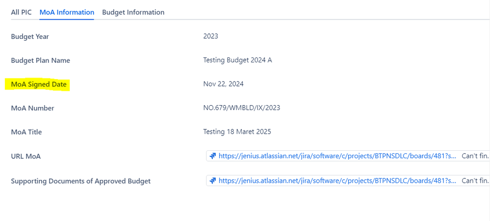

and this is the MoA Signed Date of Issuetype A

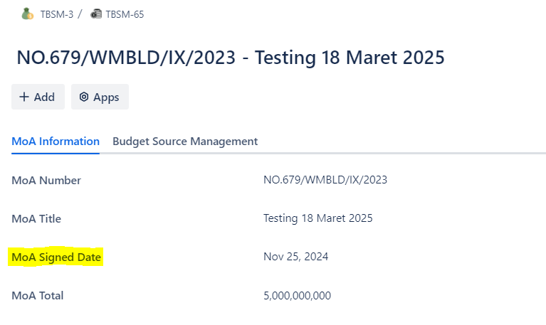

and this is from Issuetype B (MoA Signed Date didnt changed)

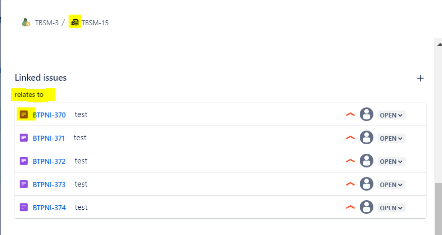

did you trigger the transition on TBSM-65? Also, is the linked issue of type "MoA Project" and is its status "Open"?
You might want to go to the JMWE Logs page and temporarily set the log level to DEBUG, then trigger the transition and check in the logs that thee post function ran.
