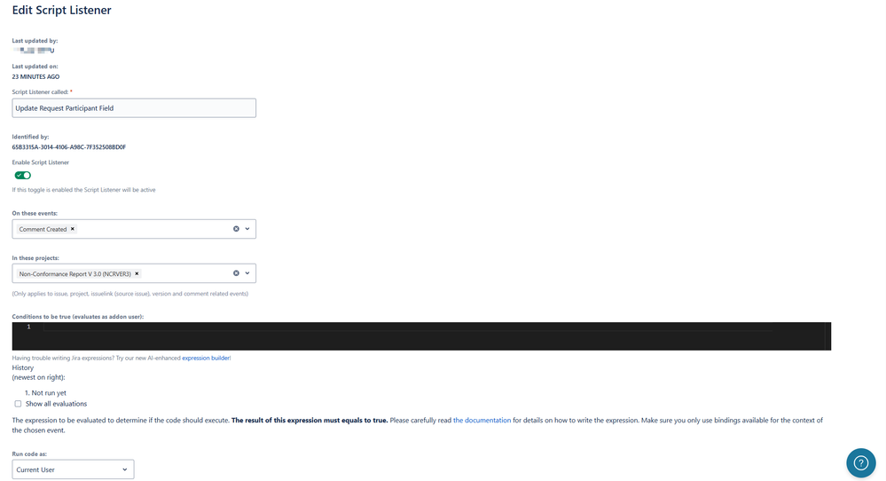

We have Jira Cloud. I am using in-browser script console.
I have a script that runs with expected outcome as long as the issue key is hardcoded; which of course defeats the purpose.
I have a Script Listener in place that triggers the script when a new comment is added.
All I want is the issue key of the of the work item on which this script will be triggered.
I have used "issue.key", "issue.id" and I get the same error
 Error: java.lang.RuntimeException: groovy.lang.MissingPropertyException: No such property: id for class: com.adaptavist.hapi.cloud.jira.issues.Issues at Script_7434c7615767409bab7286815949fe66.run(Script_7434c7615767409bab7286815949fe66.groovy:5) at com.adaptavist.sr.cloud.workflow.AbstractScript.evaluate(AbstractScript.groovy:35) at com.adaptavist.sr.cloud.workflow.AbstractScript.runScriptFromRequest(AbstractScript.groovy:98) at com.adaptavist.sr.cloud.events.ScriptExecution.run(ScriptExecution.groovy:61) at WebhookExecution1_groovyProxy.run(Unknown Source)
I just need the issue key to be stored in a variable, in this case  def issueKey
Thanks!
Screenshots below:

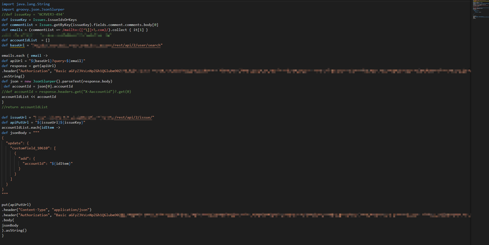

My script:
import java.lang.String
import groovy.json.JsonSlurper
//def issueKey = 'NCRVER3-494'
def issueKey = Issues.getByKey(issue.key as String)
def commentList = Issues.getByKey(issueKey).fields.comment.comments.body[0]
def emails = (commentList =~ /mailto:([^\]]+\.com)/).collect { it[1] }

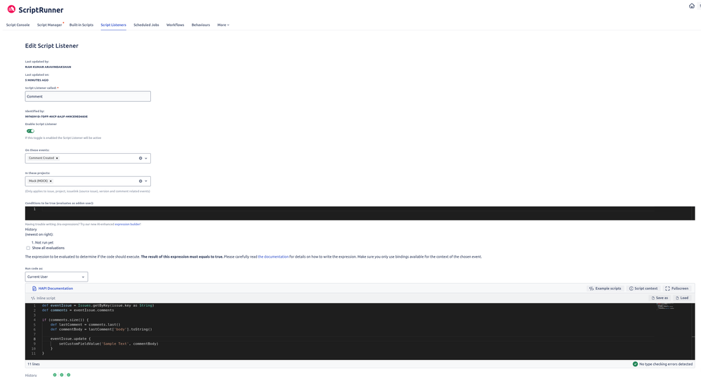

Below is a fully working code for your reference:-
def eventIssue = Issues.getByKey(issue.key as String)
def comments = eventIssue.comments
if (comments.size()) {
def lastComment = comments.last()
def commentBody = lastComment['body'].toString()
eventIssue.update {
setCustomFieldValue('Sample Text', commentBody)
The sample code above does the following: when a comment is added to an issue, the comment body is copied to a text field. The text field will only be updated with the latest comment body.
Below is a screenshot of a working Listener configuration for your reference:-
Please make the suggested modifications and retest it in your environment.
I'm looking forward to your feedback.
