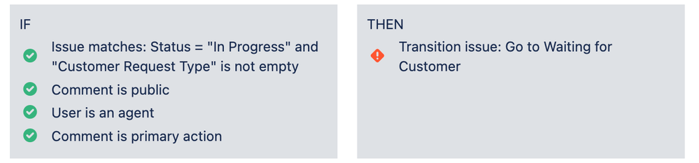

I am looking for suggestions for performing the status change of a ticket when entering a comment from "In Progress" to "Waiting for Customer". Any help, please?

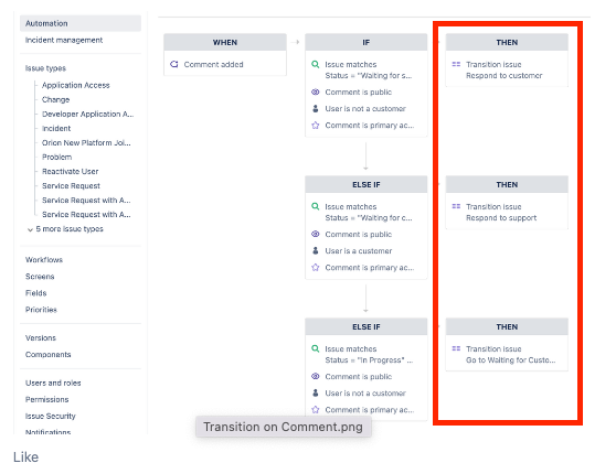

I could not find information on how to proceed based on my Jira version. I believed that maybe a ScriptRunner was needed. I had seen that there was the possibility to create an automatic workflow with customizing the rule, but I don't know how to create the transition issue action (see pic). Could you point me on the right path, please?

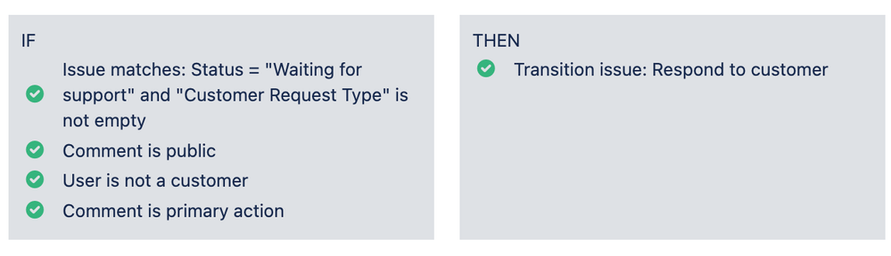

Looking at the image you attached, I see that you already have the Transition actions in it.
And it seems like the ELSE IF at the bottom of the screen covers your scenario.

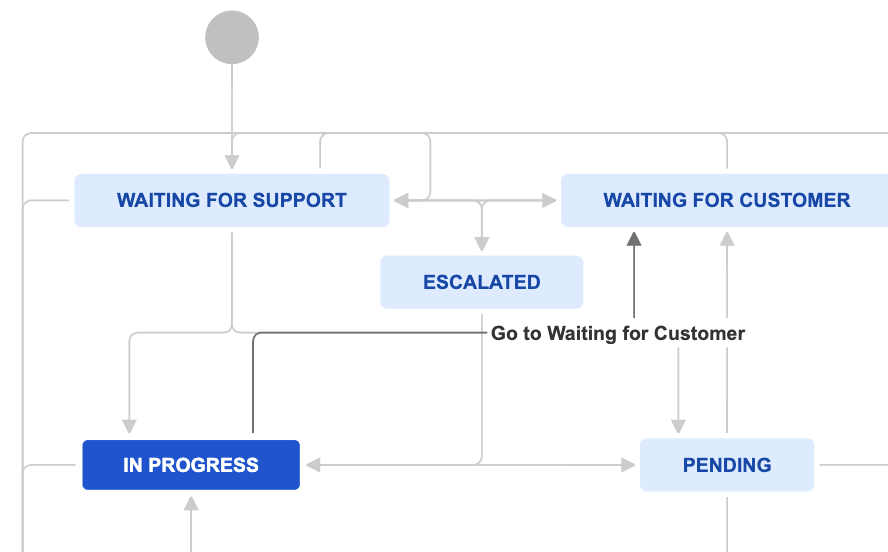

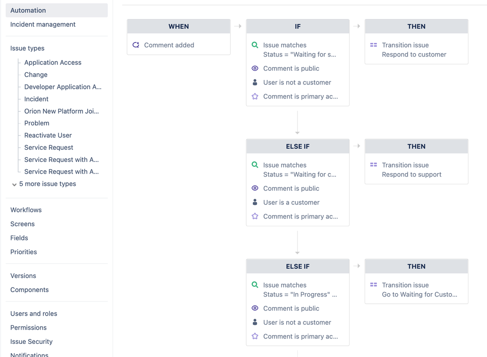

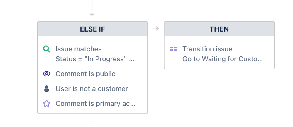

In addition to customizing the rule in TRANSITION ON COMMENT (from the option, I changed as: Run as the user who triggered the rule) I added the third condition ELSE IF / THEN, I also created a new transition in my workflow as shown in the added pic, but I am not sure if I need to add some conditions, validators or post-functions in that.
My problem is to find a way to activate this condition (change status of the ticket from "In Progress" to "Waiting for Customer") when a comment is posted by a non-customer. After the links you suggested, I found transition problems in "Jira Automation Action", but I'm not sure if it is related to my topic and I don't know how to set it up anyway. I hope this information can help you understand my problem better and I would be grateful if you could help me find a solution.

Hello @ELI0067
The automation shown in your image looks correct to me. Based on that image then it appears to me that when a comment is added by a a person who is an Agent (and not a Customer also) and the status of the ticket is In Progress and the commend is public, then the issue should transition to Waiting for Customer.
If that is not what is actually happening then please tell us exactly what is happening and show us screen images to support that the conditions of the rule are met by the status of the issue is not changing.
If you are finding any error messages, please provide those also.
You should not need to add any conditions, validators, or post functions to the transition to make this work.

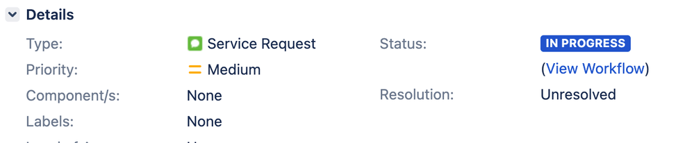

When I have the ticket in the "In Progress" status and I write a comment, the status does not change to "Waiting for Customer" and it does not show any errors. I am attaching screenshots of the customization rule, ticket workflow and ticket workflow in the status "In Progress" that does not change. Is it anything else I can check to show you?
Is the comment marked as Public?
Do the other automatic transitions in the rule work?
Is the rule Option set to run as the user that triggered the rule? If so, are you able to access an issue that is currently In Progress and directly update its status to Waiting For Customer?
I noticed from Automation - View Logs that with the castomization rules that I settled it shous the status "NOT EXECUTED" (Fig.1).
I tried to make some cominations and I saw that when I put "User is an agent" it gave me the status "ERROR" (Fig.2).

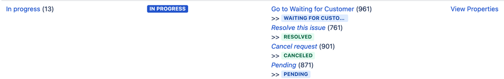

But I also noticed that in another ticket the transition works but it is not an automatic condition and in that case I saw some properties added in it and it works showing the status "SUCCESS" (Fig.3).
I tried to add the same properties in my ticket but it didn't work again. Do you have any others ideas where I can have a look?

When I have created the transition (Go to Waiting for Customer) it switches from "In Progress" to "Waiting for Customer". But then I hid it, as it showed in the ticket and it took the user (assigned to the ticket) who had to manually press it to switch to "In Progress".
Maybe this can help you to understand better the situation?
