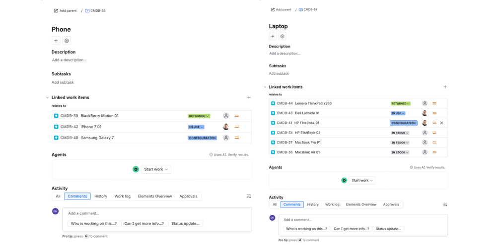

Step 1 - Turn a Jira project into your asset inventory
We'll model two things as issues: the asset types and the assets themselves.
  1. In the CMDB project, go to Project settings → Work items → Types → (Actions) Edit work types.
  2. Add a new issue type Asset type, add it to the scheme, and save.
  3. Repeat for a second issue type, Asset.
Now create the records:
  • Create issues of type Asset type for each category - e.g. Laptop and Phone.
  • Create issues of type Asset for each physical item - e.g. Lenovo ThinkPad X260, iPhone 7, MacBook Air.
Then link each asset to its asset type with an issue link (open an Asset type issue and use Link issue), creating a parent-child relationship: asset type = parent, asset = child. This link is what makes the cascade possible later.
Finally, set the Assignee of each asset to the customer who owns it - that's what lets the portal show a customer only their devices.
At this point your CMDB project is a small but real inventory: categorized, linked, and owned.

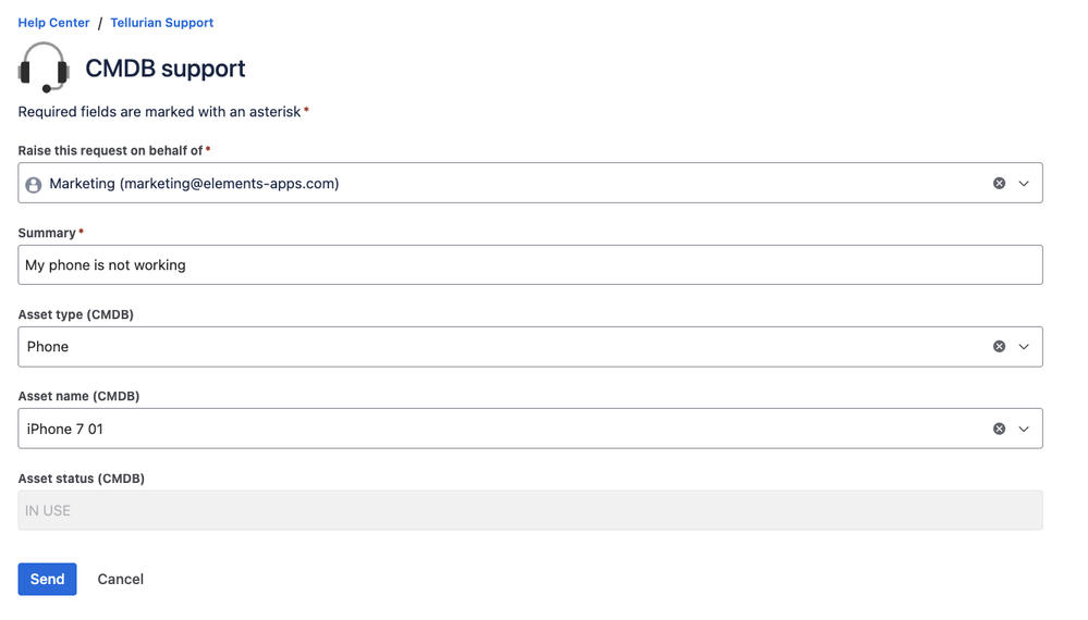

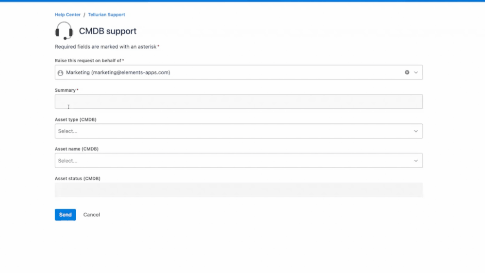

Step 4 - Add the fields to your JSM request form
In Elements Connect, go to Connected fields, and for each of the three fields use Actions → Add field to Portal. Choose your JSM project and the request type, then drag and drop the three connected fields onto the request form.
That's it. On the native portal, a customer raising an incident now:
  1. picks an asset type,
  2. sees only the assets of that type that belong to them,
  3. and watches the status of their chosen asset fill in automatically.
The result
No serial numbers typed from memory, no free-text guessing. The customer gets a guided, three-step asset picker, and the agent receives a request already tied to a known device and its current status - pulled live from a Jira project that may be sitting on an entirely different Jira Cloud site, owned by an entirely different team.
