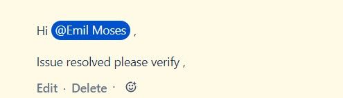

Emil Moses
November 6, 2022
Hi @Tomas Arguinzones  @LaurenS
Tried to not resolved in last comment
free text to wiki style received account id :
Hi [~accountid:62c6c10a5f45fds3d3b7b76f5a] ,
Issue resolved please verify ,
LaurenS
November 7, 2022
issue resolved! thank you very much @Tomas Arguinzones
Emil Moses
November 7, 2022
@LaurenS
Can you please let me know how did you resolved am still getting the same issue
If anyone tagged in the last comment it only gives me there iD
{{issue.comments.last.body}}
