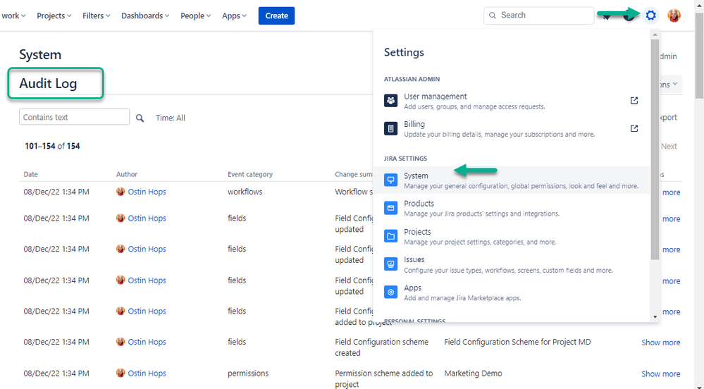

1. How to see configuration changes to Jira projects?
Check the Jira audit log. All information about global configuration and administration, security, permissions, user management, local configuration and administration, and end-user activity, you can find in the Jira audit log. It provides an overview of such events as Project created, Project deleted, Project updated, Project archived, Project restored, etc. Check out the list here: Audit log events in Jira
*You must possess the Jira Administrator global permission or be a Jira System admin. You won't be able to obtain it if all of your Jira Cloud products are on the Free plan.

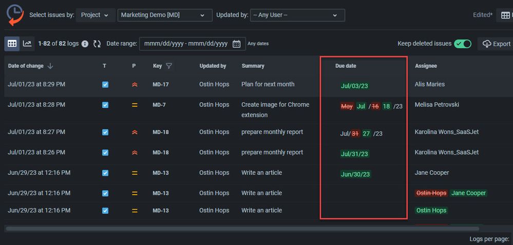

2. How to monitor all issue changes in Jira project?
Try Issue History for Jira. It is a customizable report with all issue changes recorded in one place. The app helps to track updates for all standard and custom fields, each presented in a separate column. You can choose what fields to include.
Here is an example with due date changes:monitor due date changes.jpg

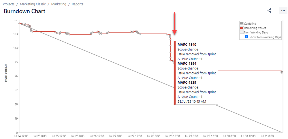

4. How to track tickets added/removed from a project backlog?
A good way to see how issues are moving in your project is Sprint Burndown Chart. It generally shows the work that was finished or moved to the backlog during each sprint. So you will know if your team is overloaded with tasks or underloaded.
If you hover the cursor over the red line, you will see what issue was added/removed/comleted during the sprint. Also, this information is available in the table below the chart.

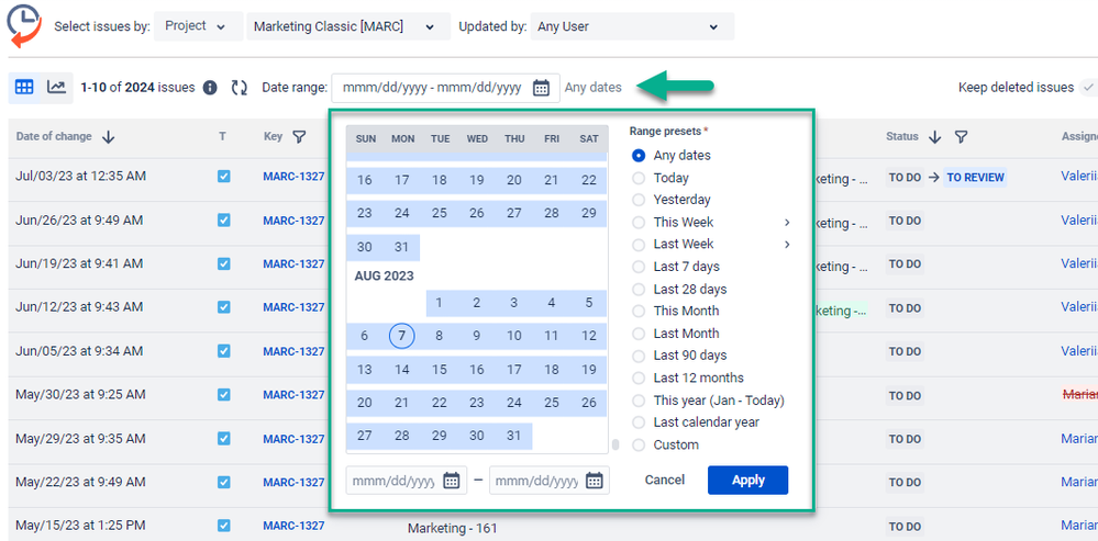

8. How to get issue changes in Jira project for specific dates?
You can choose any dates for your report with the help of Issue History for Jira app. It is equipped with an advanced date picker which provides maximum flexibility while selecting time frames. It can be a preset date range or a custom one.

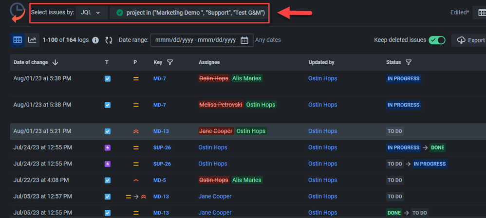

9. How to track changes for multiple projects?
Here, you can also try the Activity Stream Gadget and select all the projects you need if the order of events doesn’t matter to you. Or create a JQL filter with Issue History for Jira app and get the most complete issue changelog possible in a well-structured and customizable report.

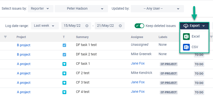

10. How to download all changes made to the Jira project?
You can export issue history using REST API, but it is a time-consuming option. Also, it is possible to export the full issue history for any Jira project with Issue History for Jira app. You can download the report as XLSX or CSV files with two button clicks. Find more details here:  How to export issue history from Jira?

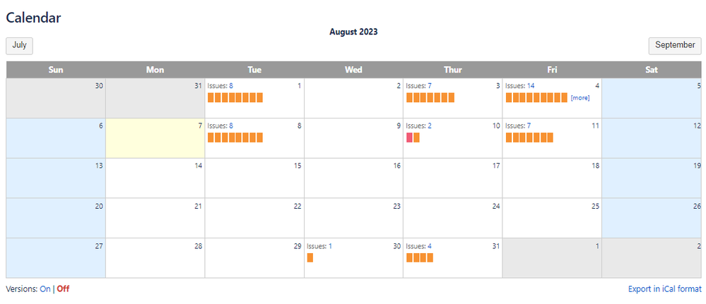

11. How to track issues’ due dates for Jira projects?
There is one convenient gadget on the Jira dashboard called “Projects” where you can see a Calendar with all issues’ due dates. Select the Project you need and choose the Calendar option under the chart icon.
