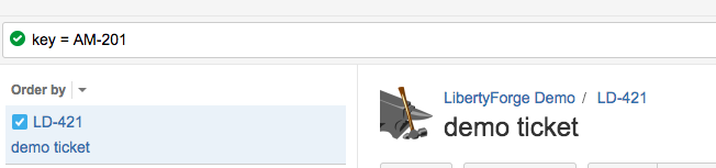

@pascal Bouchard,
The *ID* actually doesn't change, but you will change the *Key* when an issue moves because the *key* must match the parent project.
You may consider if the need for movement across projects indicates that Components should be used instead, or if you feel the need to move tickets across projects is legit, but want to search you can always search by any of the historical keys, and JIRA will still find it, and never reuse a previously used key.
Moved to:

This is exactly the workaround I was looking for. Thanks for the detailed answer. I appreciate.
