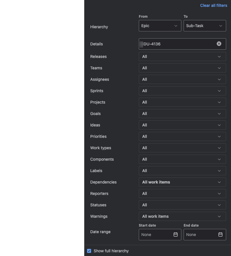

Hello all, I have a Jira Epic with 105 stories. When I bring the epic into plans, it is only showing 10 of these.
Very basic filter - see screenshot.  Anyone know why it won't bring in all the children? PlansFilter.png
3 answers

That behavior actually makes sense — your Plan is likely only bringing in the Epic itself because the JQL or issue source doesn’t explicitly include its child relationships (stories and subtasks).
When you add an Epic directly into a Plan using a JQL like issuekey = DU-4136,
Advanced Roadmaps doesn’t automatically expand its hierarchy — it only includes what your query returns.
In other words, if your JQL doesn’t describe the full chain (Epic → Stories → Sub-tasks), Plans has nothing else to show.

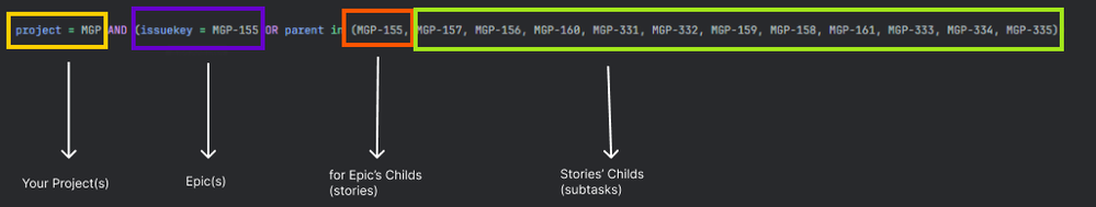

✅ Here’s a working JQL structure you can use
This explicitly tells Jira:
  • which project(s) to include,
  • which Epic(s) to show,
  • which stories belong to those Epics, and
  • which sub-tasks belong to those stories.
If you build your Plan filter this way, you’ll see the entire hierarchy — Epic → Story → Sub-task — exactly as expected.
💡 Why this happens
Plans doesn’t “assume” child issues exist unless they are present in your issue source or JQL result.
So adding only the Epic (issuekey = DU-4136) is considered an incomplete configuration, not a bug.
You can think of it as: Plans shows what you give it — not what it guesses you meant to include.

@Tess Doris  Did you try this?
Tess Doris November 13, 2025
Thank you, I did, and it worked.

Tess Doris October 16, 2025
Actually, right now I have the board connected.
