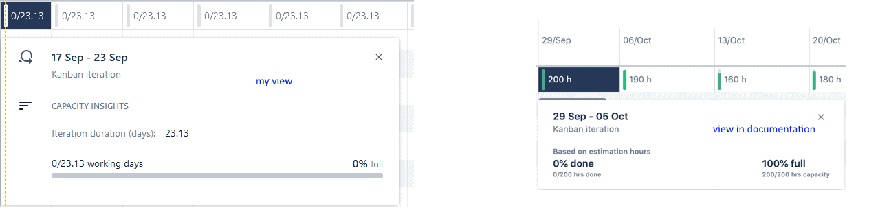

Hi,
I'm using advanced roadmap with a kanban board. When I go to the "sprint capacity management" view. The iteration estimation is empty.
Issues are estimated and estimation configuration is set to days.
What can I do to switch from my view to the one provided in the documentation ( see screenshot)
Thank you for your help

Hi Joni,
Thank you for your feedback as well.
I have assigned the issue source to the team.
I can see the capacity timeline but the "capacity bar" remains empty. In the screenshot provided, the left window is my view, and the capacity timeline is present.
Thanks
Hi @Valerie Wilson ,
I wasn't able to get the capacity to display with the planning style of Kanban and the Hours estimate. I could get it to display when I set the Team values as Scrum, 2 week sprint, and story points. When I view the information, it shows 2 week sprint with 200 weekly hours. The plan settings are set to Hours even though story points are an available option.
When I view my timeline, I see the hours planned. When I am at or under the 200 hours it is green. When I am over the 200, it turns red. What I don't like is that I can't see what my baseline about for the team like you can see with story points.

Hi Joni,
Have tried the scrum board configuration and indeed I got the capacity bar filled in but we are not working by sprints.
Thanks for your help and suggestions.
