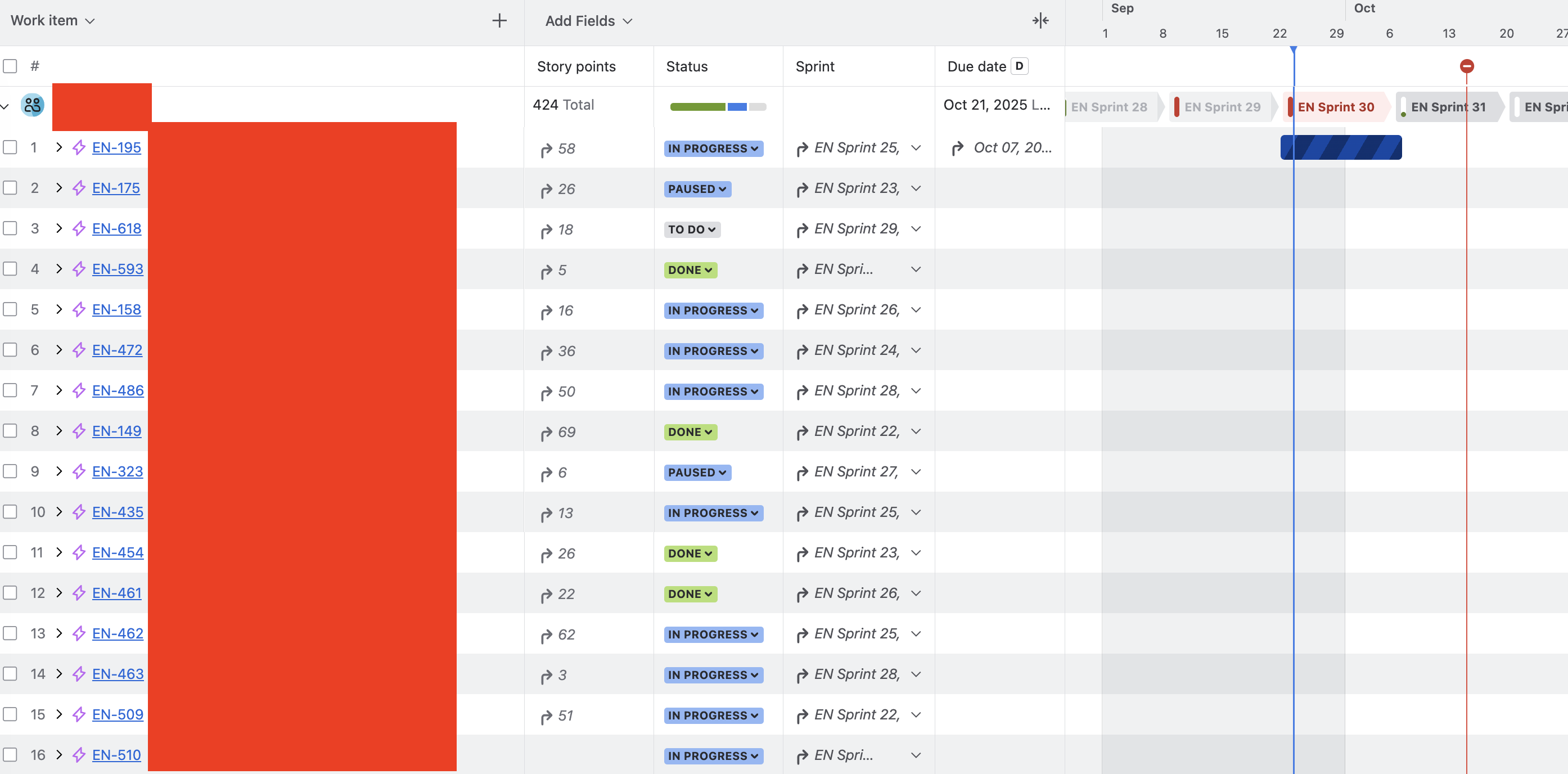

Dates roll-up in our Jira plan broke this morning. I’m not really sure what caused it, but now I only see rolled-up dates for one Epic.
I’ve already checked the following without success:
Plan settings (hierarchy, scheduling, timeline options)
Issue sources and filters
View settings (including “Show rolled-up dates”)
Despite that, most Epics don’t display rolled-up dates anymore. They worked fine before today.
As you can see, roll-up only works for the first Epic.
Would appreciate any help troubleshooting this.

Thank you for the answer, let me provide another screenshot, hope it will bring a little more clarity.
The answer is no, I don't have start date and due date set on the tickets, they are taken from the sprints. This is how it was since the beginning of the project and roll-up for Epics worked perfectly fine until this morning.
I found an older screenshot taken a couple of weeks ago - you can see roll-up dates for Epics here.

The first pic shows the roll up not happening, Have configured the dates to be taken from sprint. The second Pic shows how its rolled up for only one person but no other person can see that view. The settings are exactly the same. Your help would be appreciated.
Here is a screenshot of no rolled up dates.
Here I add the "real dates" - "3 Nov 2025" and "4 Nov 2025" to one of the tickets and you can see that the rolled up dates then display the inherited sprint dates correctly as "3 Nov 2025" and "29 Dec 2025"
However, when I save my plan the rolled up dates then incorrectly update to "3 Nov 2025" and "4 Nov 2025" is from the "real dates" that I inputted.
