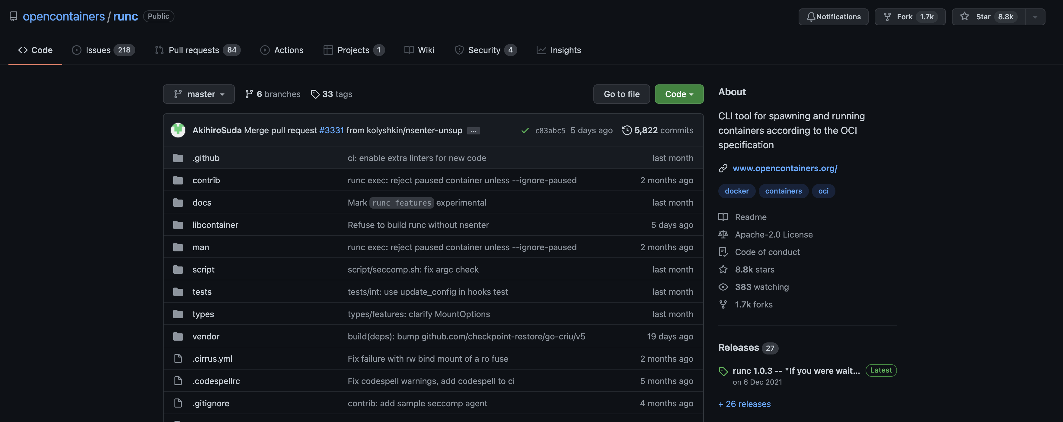

The macOS Docker Desktop application is installed at /Applications/Docker.app. Within it is a file of interest, Contents/Resources/linuxkit/docker.tar, containing a Linux root filesystem directory structure which is later copied into the LinuxKit VM. If we replace containers/services/docker/lower/usr/bin/runc within docker.tar with a backdoored version, it will then be executed by Docker in a container (called the Service Container) the next time Docker is restarted.
A backdoored version of runc can be created easily enough by modifying and compiling its open-source code.

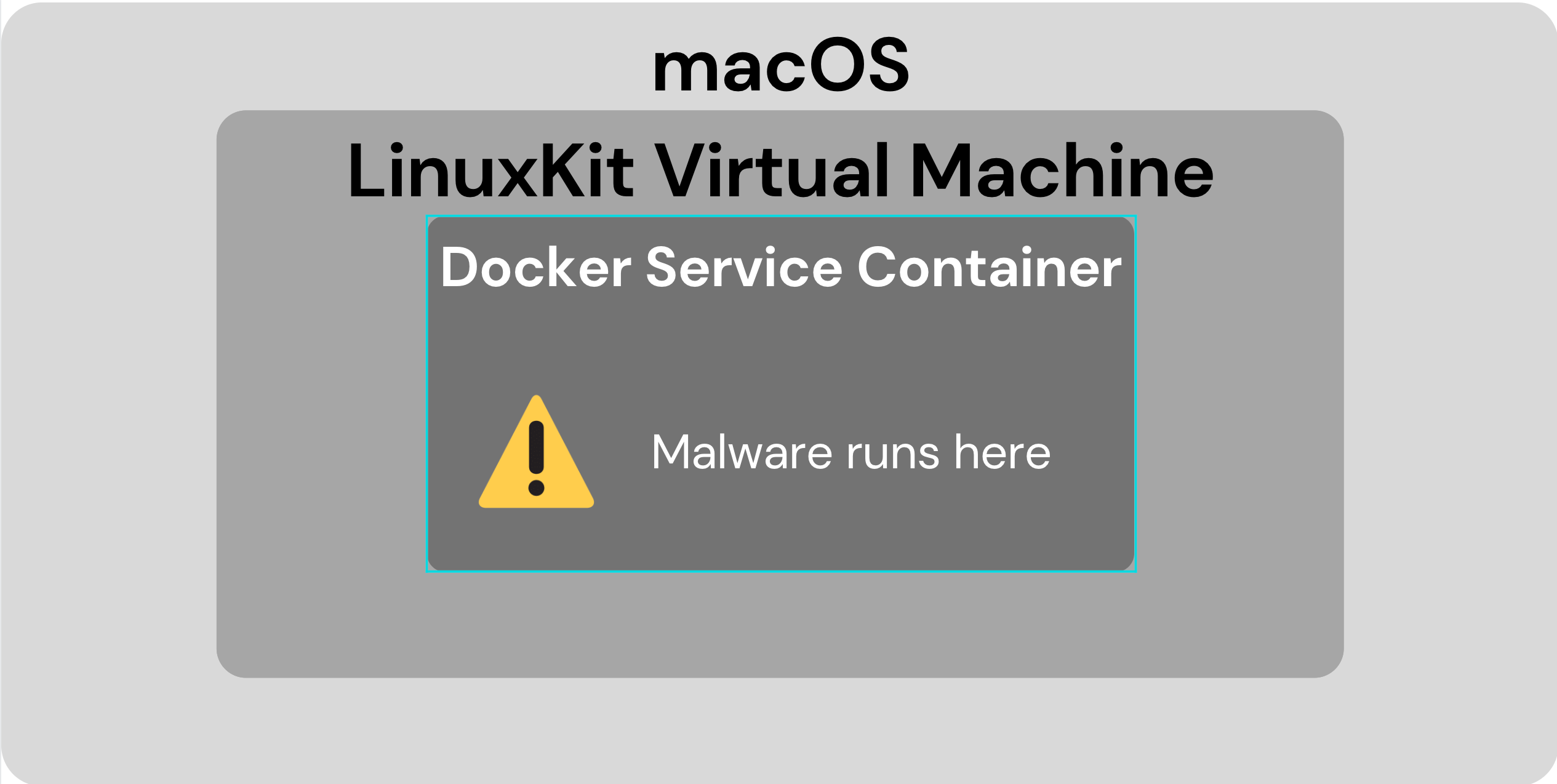

The Service Container
We're seeing both a Linux filesystem and the user's macOS directories mounted on top because we are running in Docker's Service Container. It's a Docker container, so of course, it cannot run natively on macOS. The Service Container runs where all containers run, within the LinuxKit VM. This means we are simply executing code within a Docker container within a Linux VM, neither of which the user is likely to know exist.
The Service Container is used by Docker internally, so it does not show up when the user runs docker ps, docker container ls etc.

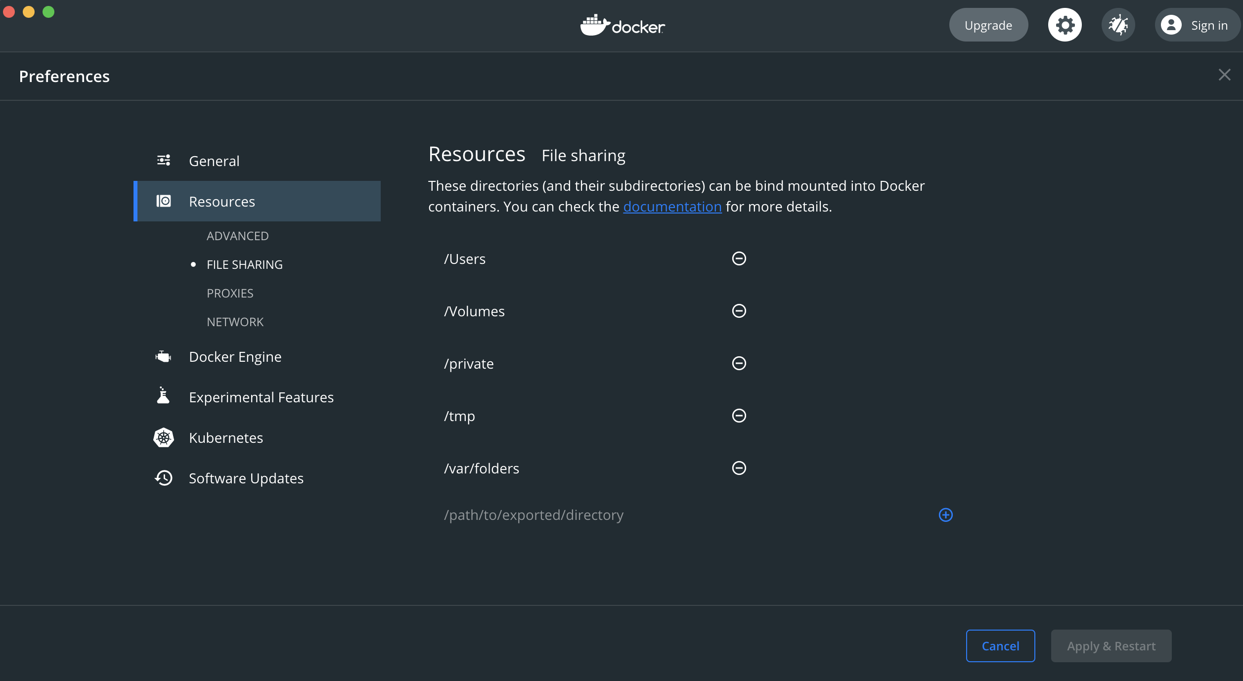

By default, the Service Container has access to the following directories on the host, mounted at /host_mnt: /Users, /Volume, /private, /tmp and /var/folders.
Although we are root within the Service Container, when accessing files on the host we have the permissions of the user running Docker Desktop. Even though we are not root on the host, most of the files containing credentials/config files of practical interest to an attacker are within /Users (e.g. ~/.ssh, ~/.aws, ~/.bashrc).
Gaining access to more directories
Still, if we want to access even more directories on the host, we can, by editing the Filesystem Sharing option in Docker's config file. Confusingly, we can share any directory from the host which does not already exist within the Service Container. For example, we cannot mount /bin from the host to the Service Container, since /bin already exists in the Service Container's Linux filesystem. We can mount /Applications, since /Applications exists only on macOS, not Linux.

filesharing_dirs = settings["filesharingDirectories"]
sync_dirs = settings["synchronizedDirectories"]
filesharing_dirs.extend(["/Applications", "/Library"])
sync_dirs.extend(["/Users", "/Applications"])
# Append extra dirs to fileSharingDirectories.
settings["filesharingDirectories"] = filesharing_dirs
# Synchronise directories with the VM so we can read/write to them in sync.
settings["synchronizedDirectories"] = sync_dirs
# Don't alert the user by popping up the UI when we restart Docker Desktop.
settings["openUIOnStartupDisabled"] = True
json.dump(settings, open(DOCKER_SETTINGS_FILENAME, "w"), indent=4)
