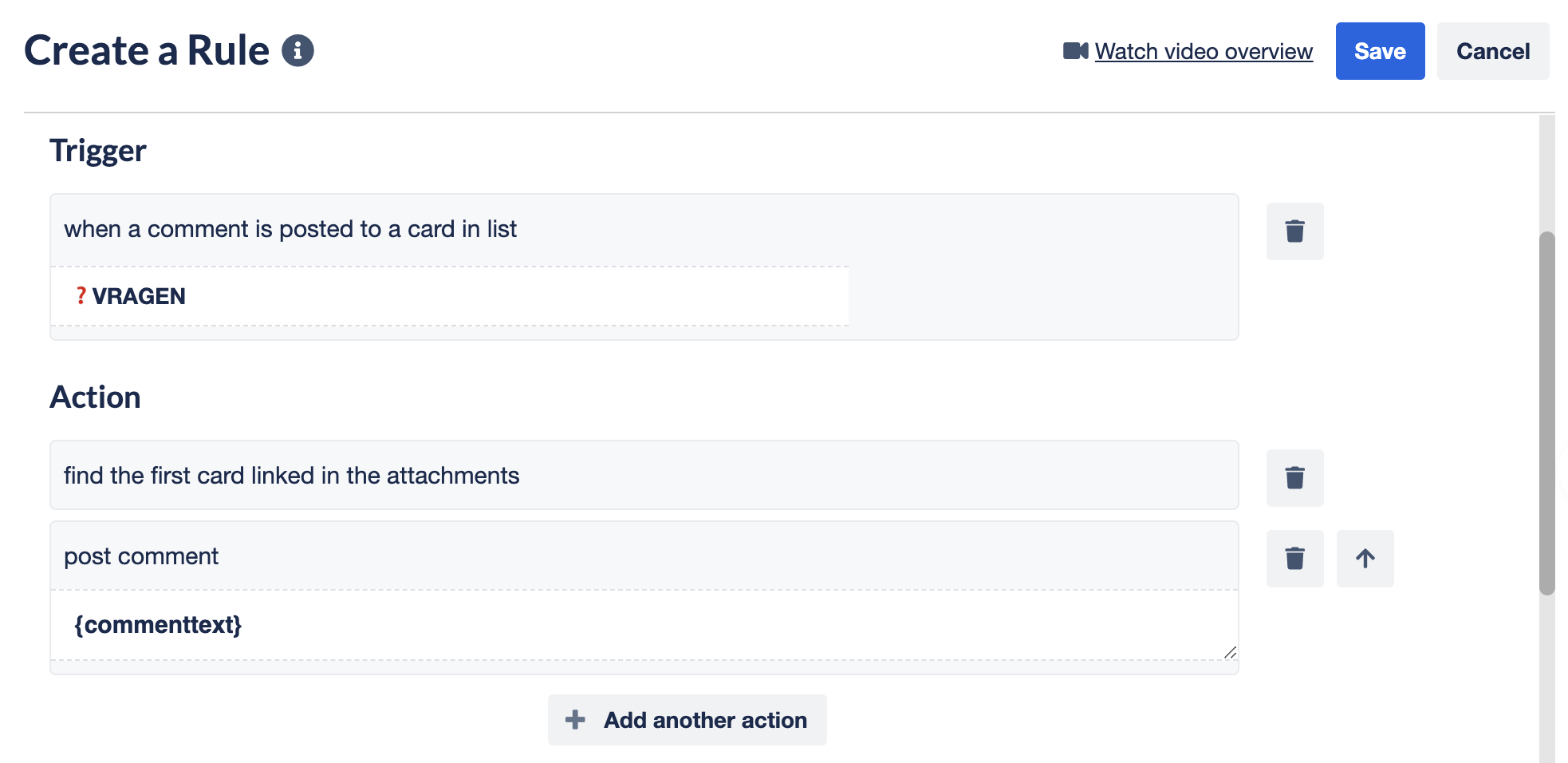

Hello,
I have this rule on my board when i post a comment to a card in this list it works for the linked card but for the card where i post te comment it also post the exact same comment (again). So now i have the same comment twice in the card.
In the "post comment" action there is no option where i can specify that i only need this on the linked card and not on the card where i post the comment, this wil confuse my clients.
Is there a solution for this?

Try this automation, enabled on both boards...
Kelly May 21, 2024
Yes, this worked like a charm! Thank you so so much! Not only for your help but also for your persistence with my problem.
(Do not forget to also put the ** in front and at the end of the word Comment in the trigger, it's so specific...)
