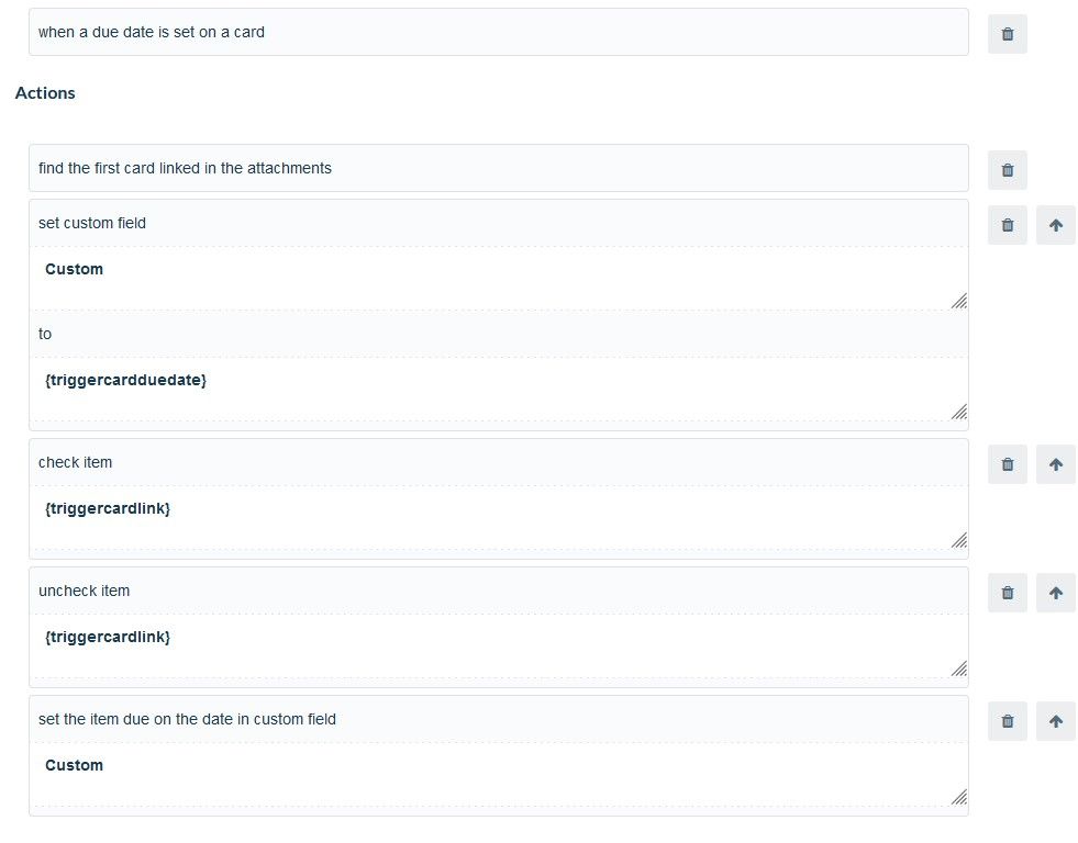

This works but it sets the time as of today. While I want to set the due date checklist the same the due date card, which can be at another date.
It's ugly, but i was inspired by your post to creat this : it solves my issue
I'm using a created custom field where the new due date is stored, then I inject it in the function.

@Israphil
I tried to replicate what you did here, but was not successful.
It appears that you are using a text-type custom field but the "set the item due date on the date in custom field" option would only let me use date-type custom fields.  And since the initial "set custom field" only allows you set text-type fields (not date-type), I can't use it at the last step.
Is your automation still working? What happens if you try to recreate the same automation from scratch?
Perhaps Trello has modified/updated the automation UI since then, and no longer allows test-type custom fields to be used to set the checklist item due date.

Hi @Joon Shin
Try this:
when a due date is set on a card, find the first card linked in the attachments, set custom field "Date" to "{triggercardduedate}", uncheck item "{triggercardlink}", and set the item due on the date in custom field "Date"
