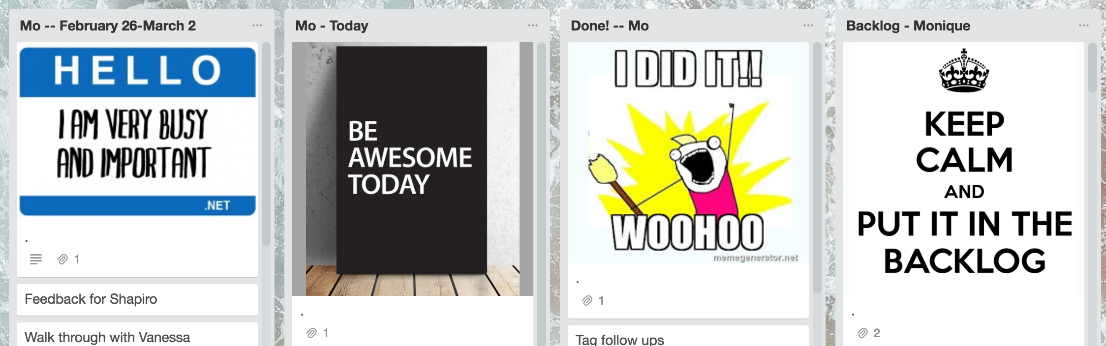

Of course, I use Trello on a daily basis since I work for Atlassian! Here's a glimpse at my Trello board:
However, one challenge I have is with recurring tasks. Right now I use Trello for everything except recurring tasks, which I put on Google calendar.
