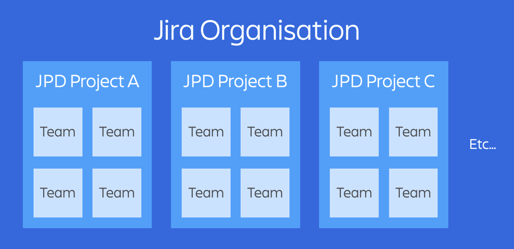

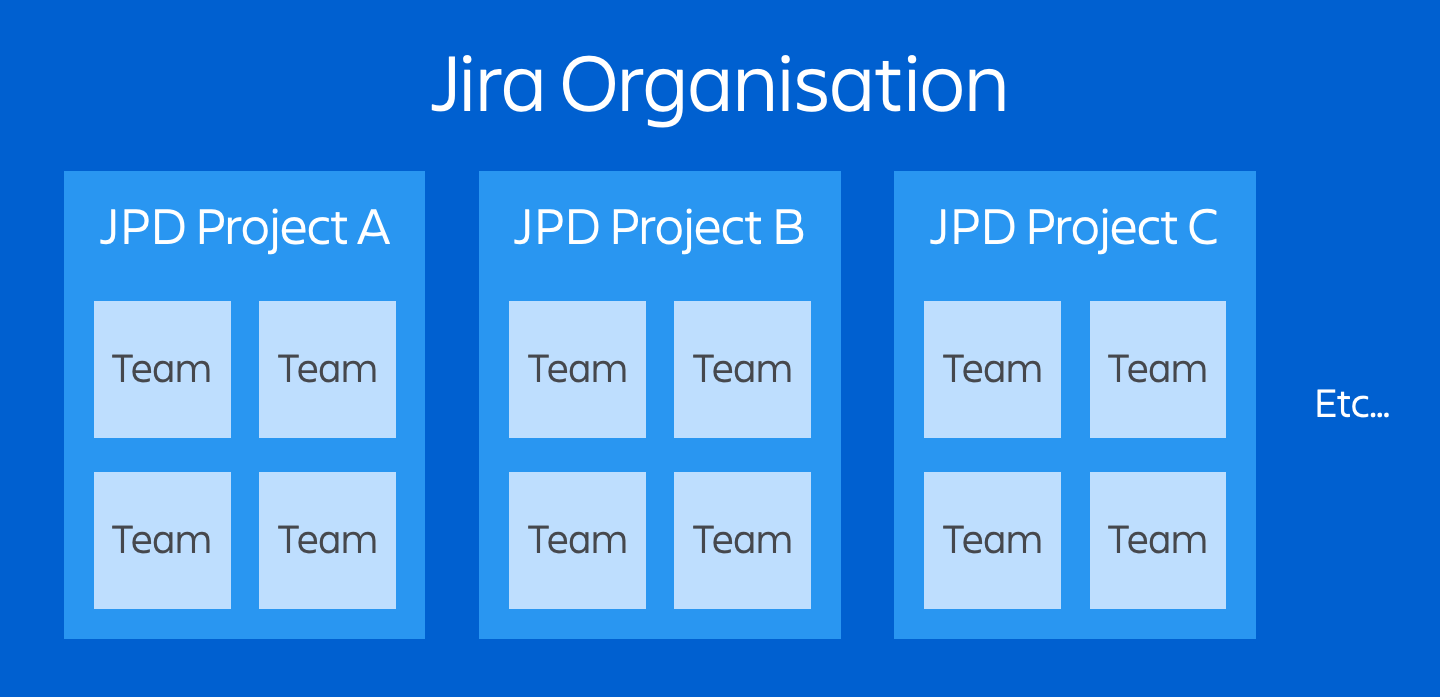

Jira is developed by many teams within Atlassian (we refer to this as the Jira Organisation), and these teams are organised into small groups that each have a shared mission (we refer to these as Pillars). Each Pillar maintains a roadmap in their own JPD project for how they plan to move their mission forward, which in turn moves the overall Jira mission forward.
The trouble we found with roadmaps being in different JPD projects is that it was difficult to see the overall roadmap for Jira. For example, if someone wanted to find out what's shipping across all of Jira in the next quarter, they would either need to check many JPD projects - each of which is configured differently according to team preference - or they'd need to speak to each of the roadmap owners - and then compile the information in Confluence. All in all, it would take a lot of time to gather what should ideally be readily available information.

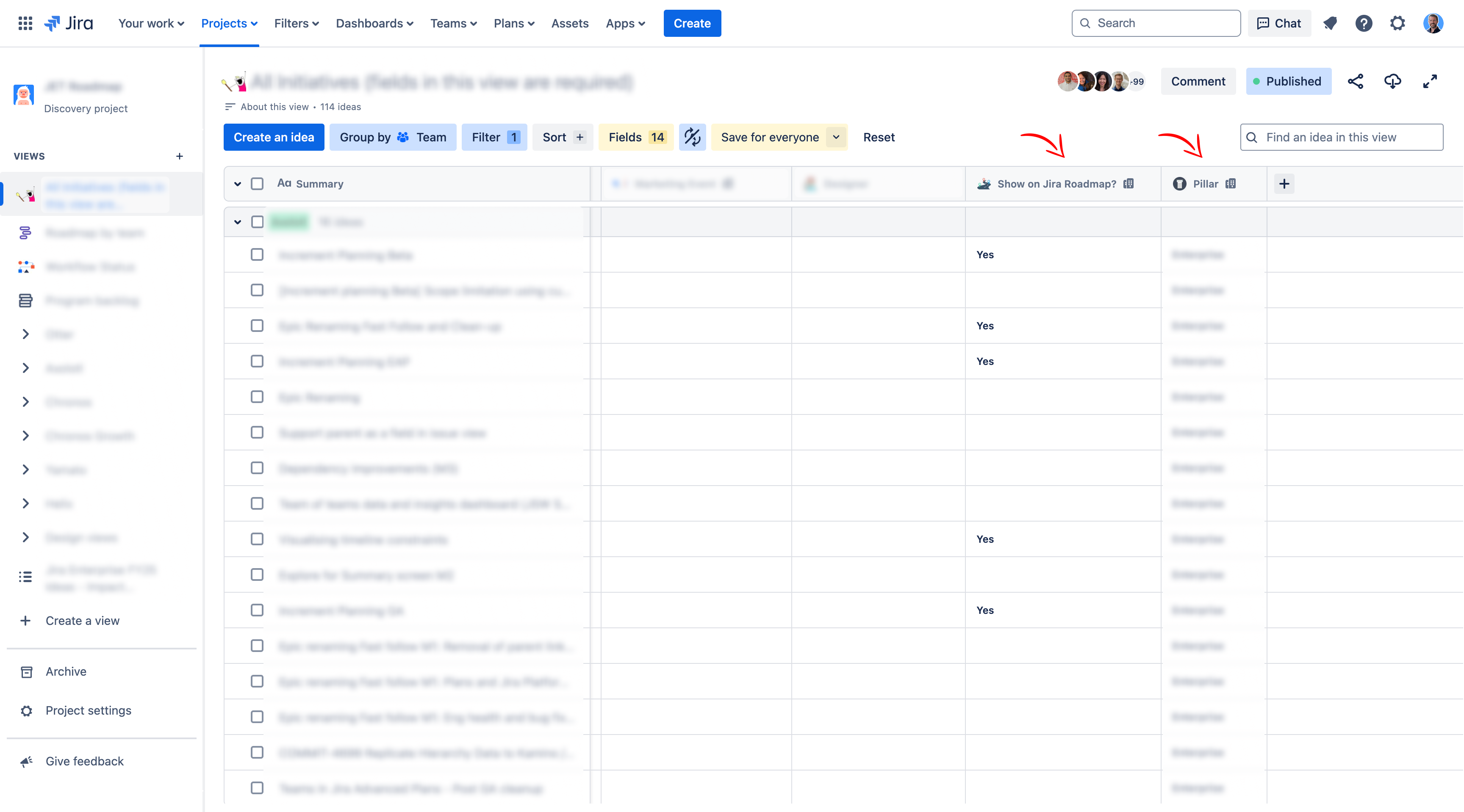

Step 2: Add Global Fields to JPD views and populate
After the Global Fields were created and added to the JPD projects by admin, I then added them to the relevant views in JPD and had roadmap owners populate them. I wrote a guide and handy checklist in Confluence to make it easy for everyone and I recommend doing the same.

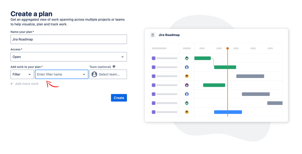

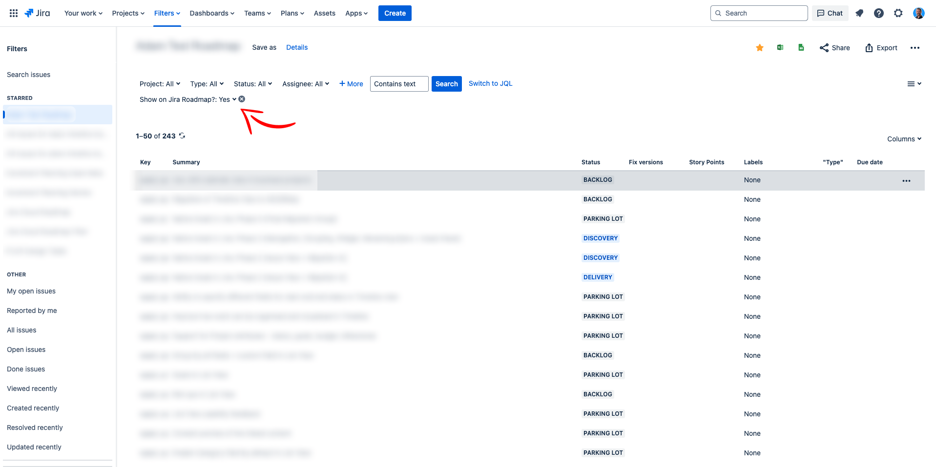

Step 3: Create and save a JQL filter
When setting up the Plan I needed to define the issue source. I created a filter to find issues where the Show on Jira roadmap? field = yes, utilising the field I mentioned in step 1. I then saved the filter so that I could use it as my issue source when creating the Plan.

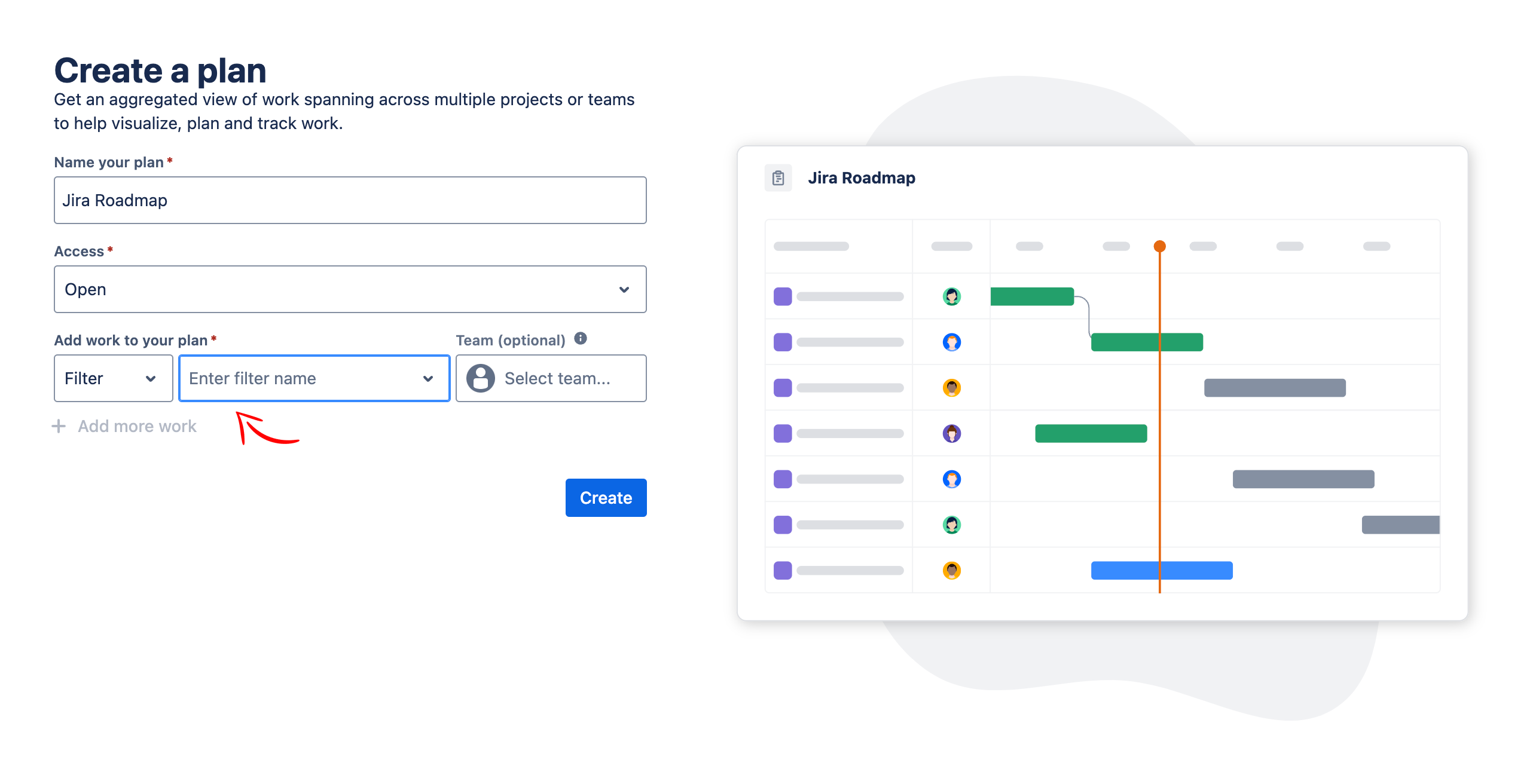

Step 4: Create a Plan
I then created a Plan and followed the setup steps. For issue source, I selected filter and chose the filter I saved in step 3.Group 5.png

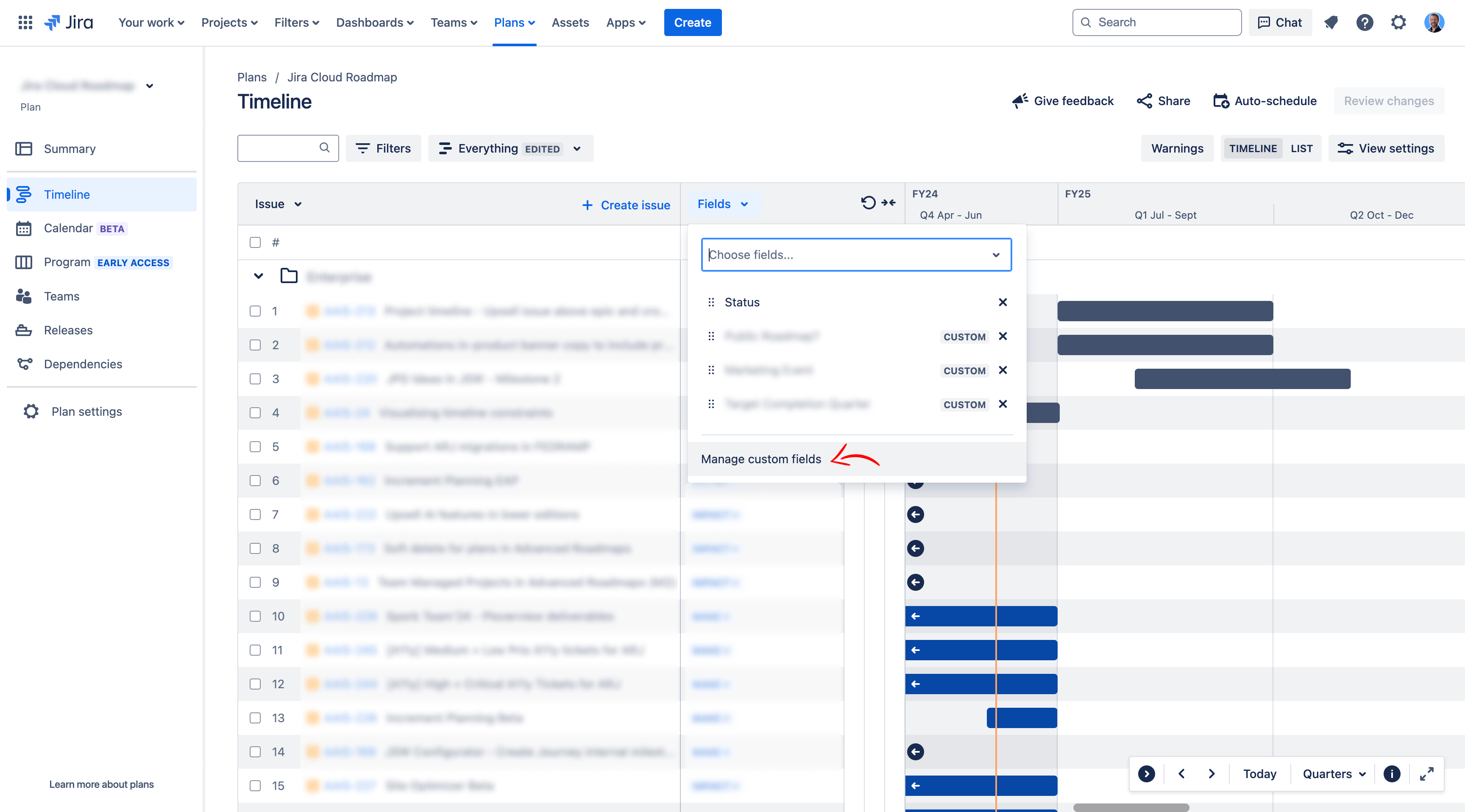

Step 5: Adding Global Fields to the Plan
Now that the Plan is set up and the roadmap items are showing from the JPD projects, it’s time to add the Global Field, Pillar. To do this head to Fields and then Manage custom fields. From here you’ll be able to find and add whatever fields you’d like.

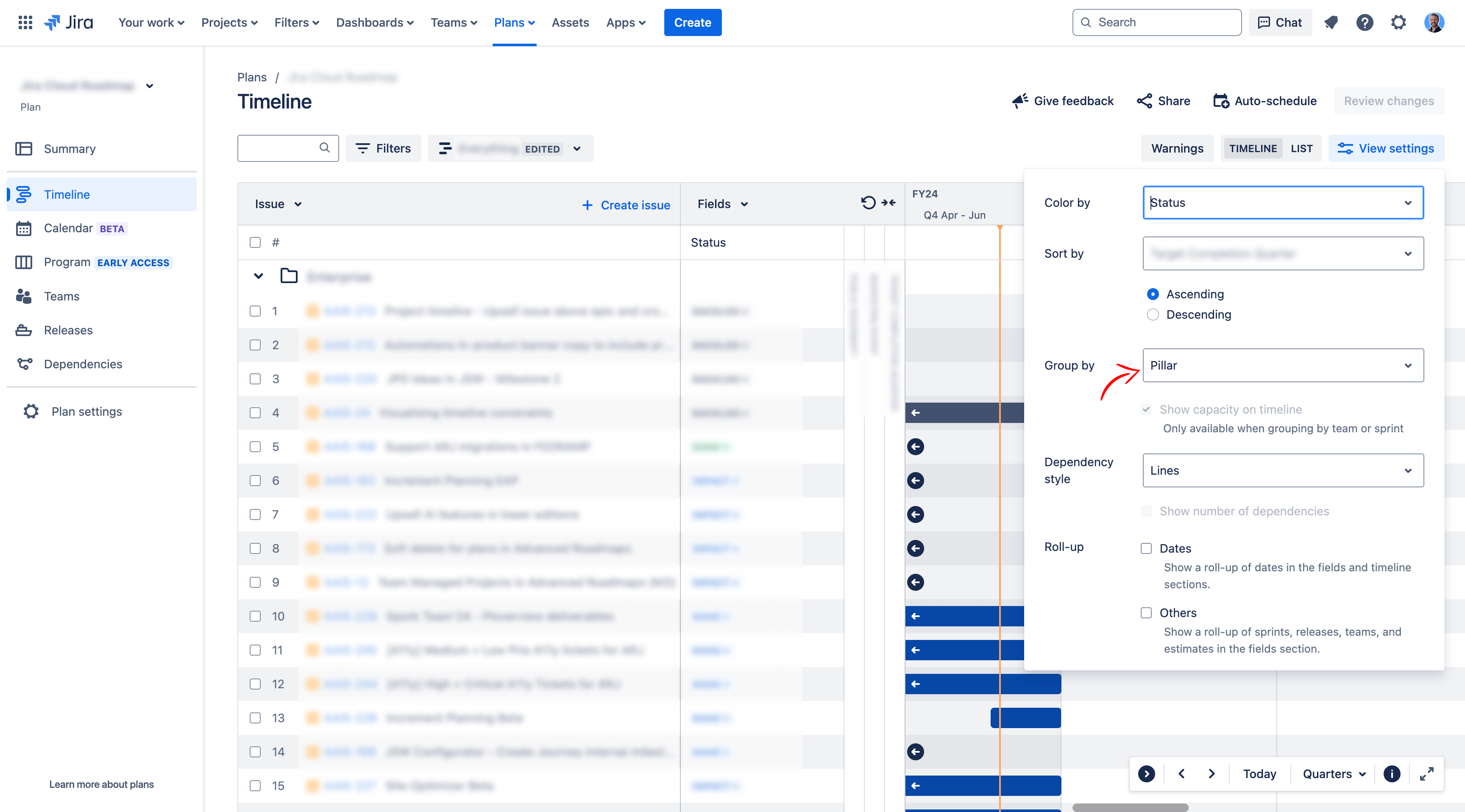

Step 6: Set up views in the Plan
I then modified the views in the Plan to make sure it served our needs. For example, in View settings I grouped by the 2nd Global Field that I described above in step 1 - Pillar. That meant that whilst we could see the overall roadmap, we could still see which group owned what items.
I also set up a number of saved views. For example, I had one view which showed every roadmap item, and then I had another which showed items belonging to a subset of related Pillars.

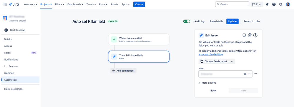

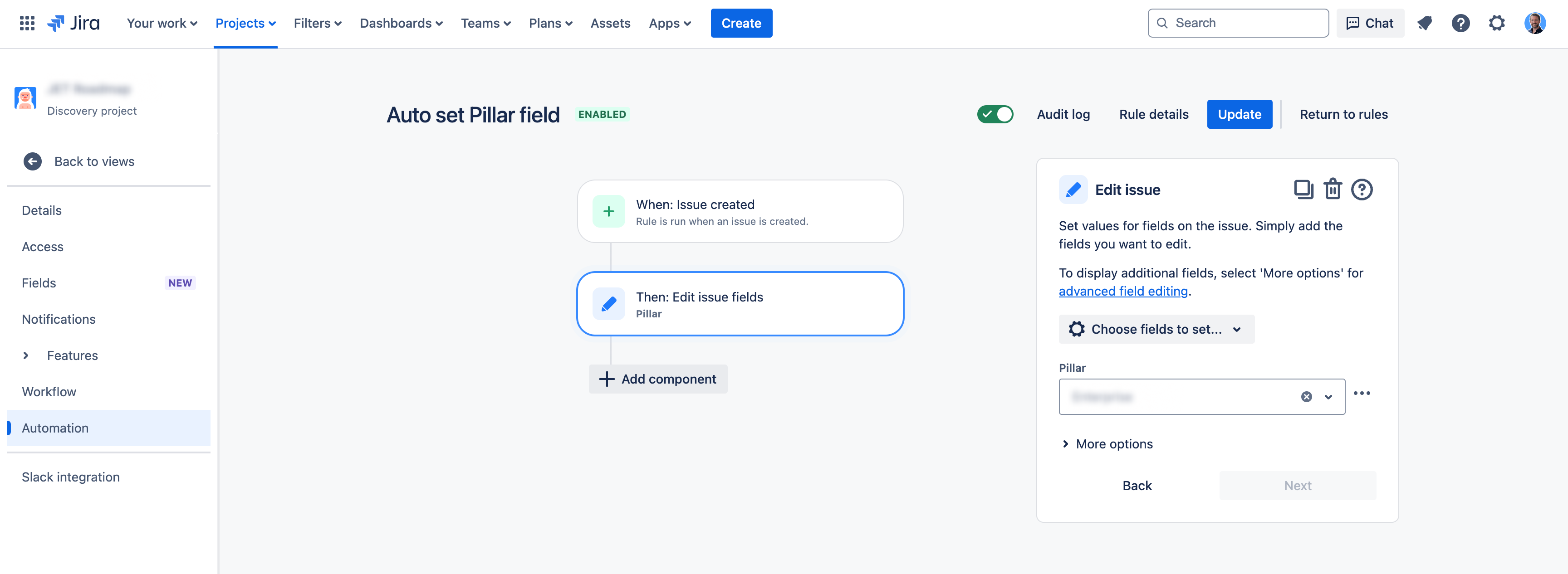

Step 7: Automate
Automation is a great way to save time/effort on certain tasks.
For the Pillar field, I set up automation in each JPD project so that this was automatically set every time an item was created. The field value was always the same in each JPD project, so this was a simple repetitive task that I could automate.
