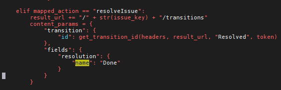

This is the code which suppose to handle resolving issue:
elif mapped_action == "resolveIssue":
result_url += "/" + str(issue_key) + "/transitions"
content_params = {
"transition": {
"id": get_transition_id(headers, result_url, "Resolved", token)
"fields": {
"resolution": {
"name": "Done"
(Above code looks better in script in terms of spacing)

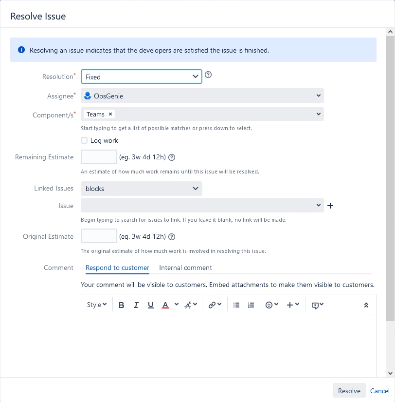

Permissions for the user are OK. I tried to do it manually and it works normally. When I comment out those lines for fields and resolution, it resolves issue but with resolution as "Incomplete" which is not acceptable. So either it ends with above error about resolution or as incomplete. I need to resolve issues as "Fixed".
Also I tried to change "Resolved" to "Resolve Issue" but it generates different error:
"errorMessages":["\'transition\' identifier must be an integer"],"errors"
Also I tried to add other 2 mandatory fields (components and assignee) but it ended up with the same error about not appropriate screen.
Creating issues works fine and adding comment too, just resolving is not working.
Added some screens as well. Jira v8.5.5. Let me know if some important info is missing.

Problem solved. Transition ID was the problem. By default it was putting there ID 1311 which stands for "Incomplete".
In project settings - workflows I was able to find proper one for "Resolve Issue" which is in my case 2471. Afterwards I updated python code to below and resolving issues with resolution "Fixed" is working properly:
Not sure why it takes ID 1311 by default but "hardcoding" ID 2471 solved the problem for me.

The other thing I have noticed from your screenshots is that your call appears to trying to set a resolution of Done. However in your text you mentioned wanting to try to set a resolution of Fixed. Since we can see in the screenshot there is a resolution called Fixed, let us try to change the payload to use the "name":"Fixed" value instead.

I have a feeling those transitions are causing troubles. I added code to print content_params as well:
Content params START==========================
Content params are: {'transition': {'id': '1311'}, 'fields': {'resolution': {'name': 'Fixed'}}}
Content params END============================
Fixed vs. Done: I was just trying everything what came to my mind. Now I have there "Fixed". "Done" would be OK too I guess, certainly "Incomplete" is not OK.
