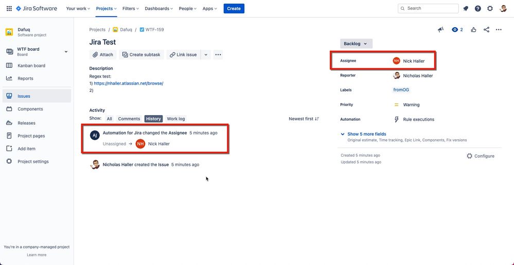

Then in Jira - create an Automation Rule that filters on this comment, and assigns the corresponding user to the issue:
Here's an example of that in action:
One thing to be aware of is you'd need an automation rule for each user, so it's not exactly scalable on a larger level, but it is realistically the only workaround at this time.
-Nick
