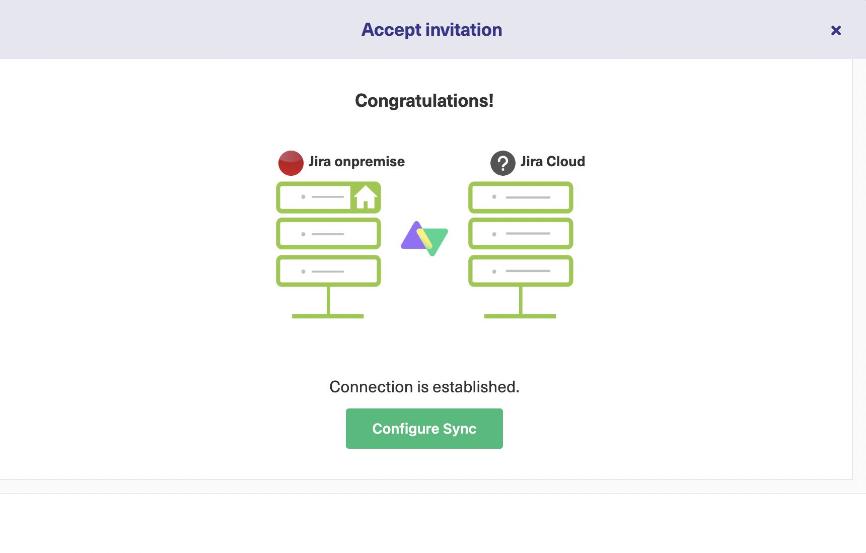

You must install Exalate on both platforms: Jira Cloud and Jira on-premise.
Then create a connection between them. A connection works as a secure gateway to start sending information back and forth.
You can find a lot of help online regarding this on the Exalata Academy and the Getting Started Guide
Implementation using Exalate

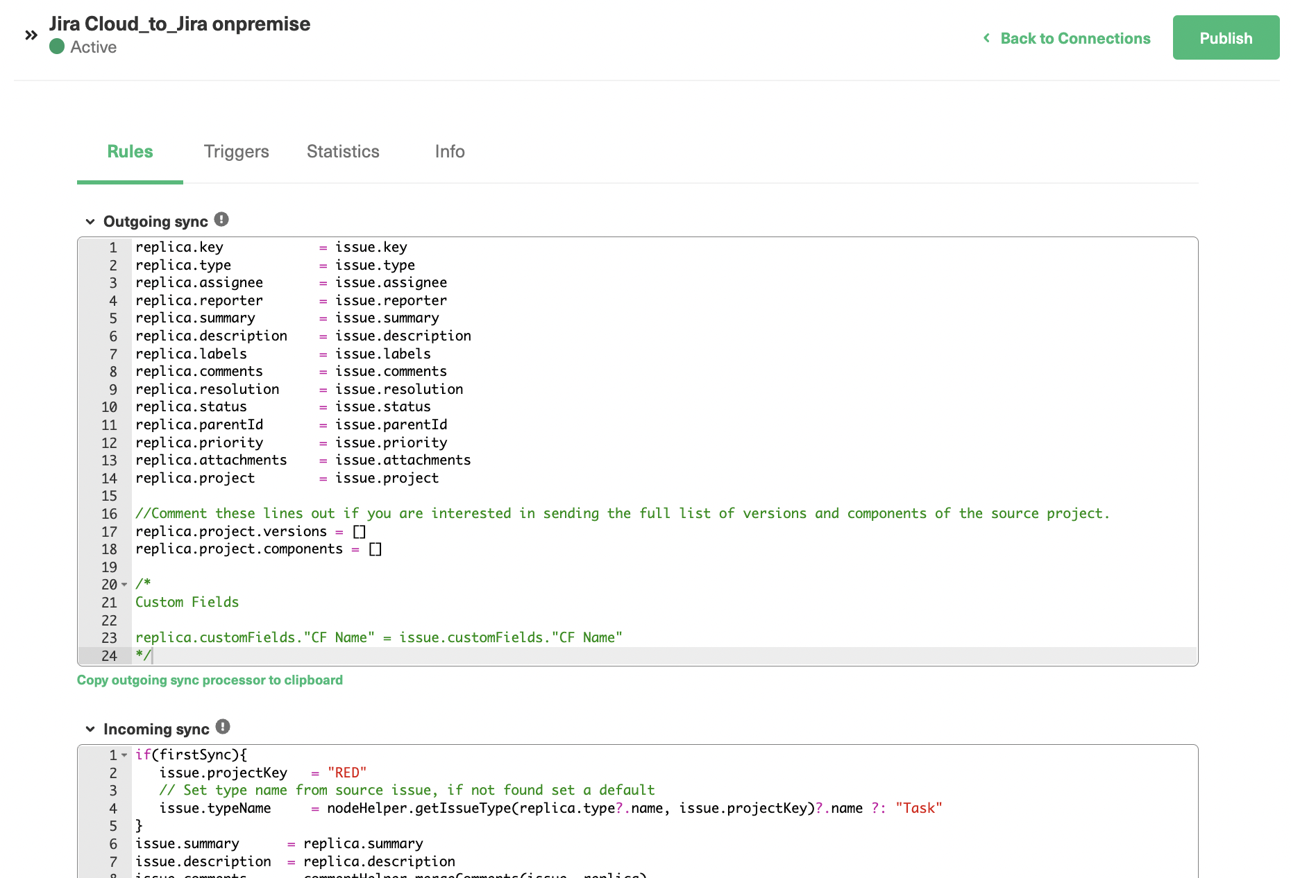

After setting up the connection, you should configure the sync rules to control what information must be sent and received at both ends.
Then you can set up triggers to enable the automatic exchange of information.
You can reach the configuration screen by clicking the “Configure Sync” button. Or you can even click the edit button on the connection list.
The sync rules (“Rules”) tab consists of the following two sections: the Incoming sync and the Outgoing sync.
 In Jira Cloud:
  • The “Incoming sync” denotes information send from the Jira Cloud to Jira on-premise.
  • The “Outgoing sync” denotes how to interpret information from Jira on-premise.
These syncs exist on the Jira on-premise instance as well.
