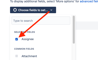

The problem is that you have specified the field to set in both the JSON code and in the Choose Fields to Set section above the JSON code.
You can't have the field in both the Choose fields section and in the JSON code.
You need to click on the Choose fields to set pull down and uncheck the copy tasks assignee users in marketing field. In my example I have the Assignee field selected.
