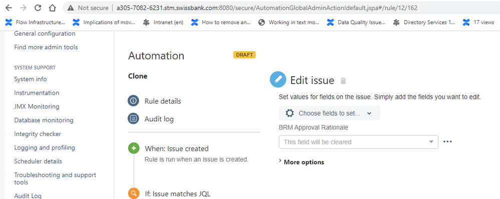

Hi @Chris Fontana  ,
I am facing a strange issue with the automation rule.
When I use the automation for only one custom field , it works all fine.(PFA)
image.pngBut when I use it for multiple custom fields it fails.
Any idea what could be missing here.
