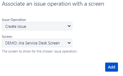

Issues - Configure Screen Scheme >> Associate an issue operation with a screen
When I select this - I see a current association with a screen ("Demo" = live project).

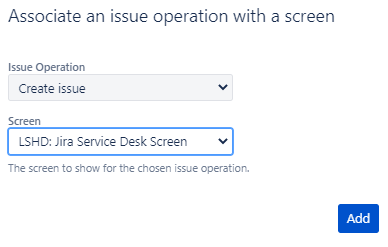

If I select a new screen (LSHD - test project) - does it break the current association?
Is it a 1:1 or can it be a 1:many ratio?
It might do, but there's not enough information in your screen shots to tell us.
The question is if you are in the same "screen scheme" in each screenshot. If they are separate screen-schemes, you are fine. If they are the same screen-scheme, then yes, you will be replacing what "create" uses.
They are in different screen-schemes.
But in "Configure Issue Type Screen Scheme (for LSHD: Jira Service Desk Issue Type Screen Scheme") - I added the 2 Issue Types I needed and now I see the LSHD: Jira Service Desk Issue Type Screen Scheme in 2 Screen schemes - the bottom one (Demo) is live.
Will this affect that project? I am not understanding the "screen scheme" and "Issue type" screen scheme clearly in my head.
NM my last bit. I realized 2 issue types use the new screen scheme and 2 use the other, so this is actually displaying correctly. Your answer is appreciated.
Sorry for the delay in response, I am not the most organised of people.
Short answer: "They are in different screen schemes" means you are doing the right thing and you will not break the associations. (And, as reassurance, even if you missed it and got the wrong scheme, you will not have done any lasting damage to your data, you can simply change it back)
