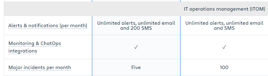

We have just run into this same issue today. Where on the pricing page is this limit mentioned? I would not have bulk-invited our 100 staff if I had known this would happen! :-/
As @MD. Gause Shibli says, the pricing page says "free forever for 3 agents" and "unlimited email" (as highlighted in the screenshot).
I don't have the possibility of upgrading to standard at the moment. How do I contact support about this?
@MD. Gause Shibli @nwright_hgs
As you can see on pricing plan summary, the unlimited notifications are only for IT operations management (ITOM), not for IT service management (ITSM).
Let me try to further clarify:
Jira Service Management is bundling together different products that already existed before under different names. For example:
In other words, the unlimited notifications are for Opsgenie only, not for JSD. Also, the notifications limit is explicitly mentioned in below 2 documentation pages:
Once this has been said, I am forwarding your feedback to the product team asking to add the notifications limit to the pricing plan summary since this can indeed cause confusion.
Cheers,
Dario
