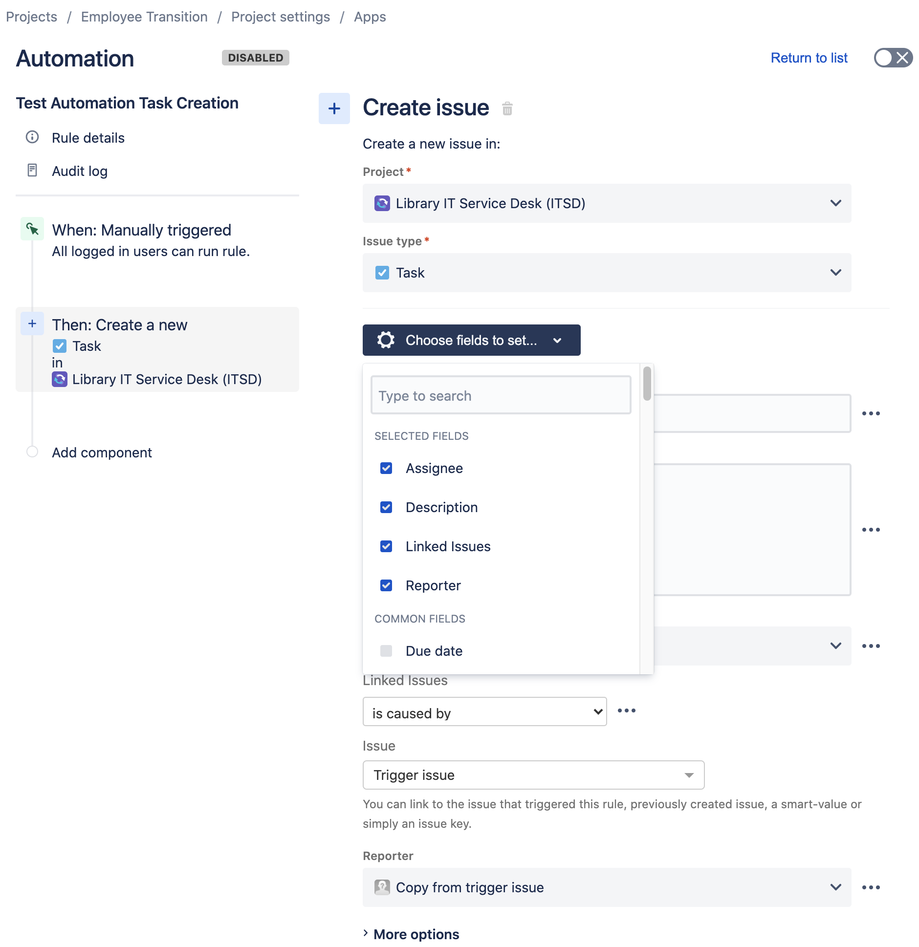

I have 2 projects. Project A has an automation that triggers a task to be created in Project B. Part of the automation task creation includes the fields (Assignee, Description, Linked Issues, and Reporter). Screen Shot 2020-10-15 at 3.34.06 PM.png
The task is created in Project B. The 4 fields are populated with the original information from Project A.

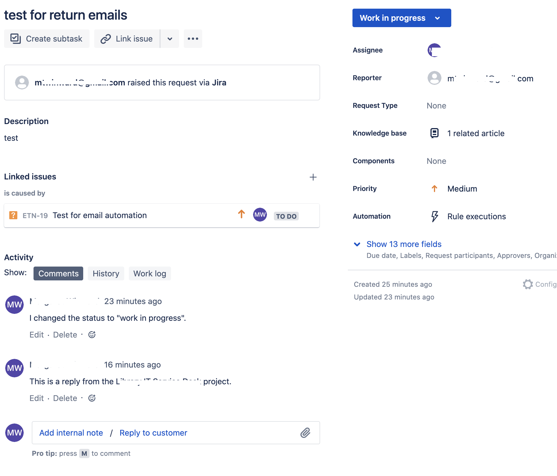

I can reply to the customer in Project A (originating issue) and it will email the customer. When I reply to the customer in Project B (issue created from automation), the customer does not receive the email.
How can I get the Project B request to send the email to the customer?

When using Jira Service Desk, what triggers the notification for customers is the Request type. When this field is empty, the reporter, participants, and organizations won't receive notifications and they also won't be able to view the ticket in the customer portal.
On the screenshot of the ticket in project B, I can see that the Request type is set as None, that's why they are not receiving notifications.
The project automation, currently, doesn't have the option to set a Request type because there is no API for that, but we can still use the other Automation in Service Desk.

The empty Request Type was the problem. Thank you for your help!
