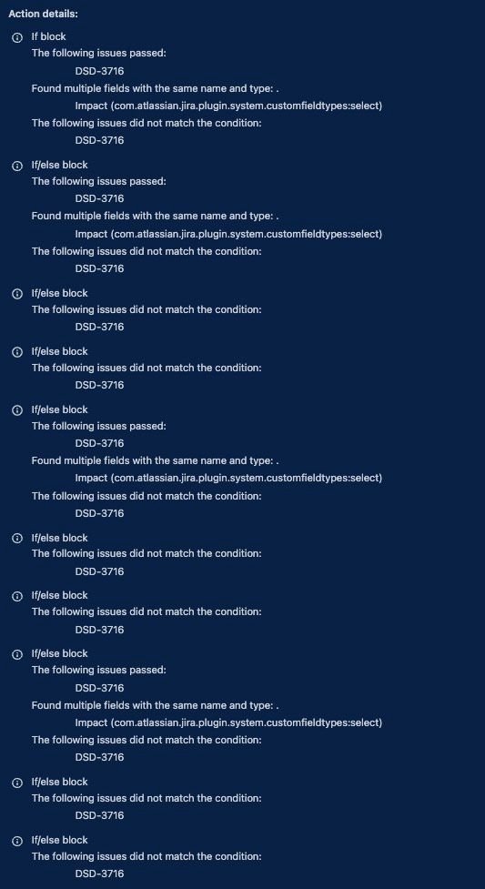

@Petter Gonçalves -- Hoping you can assist me and I can append to here as its a similar issue. I'm not able to successfully run a variation of this rule (urgency/impact are required values, so the rule runs on issue creation). However, the only useful information I had in the audit logs was this:
Initially, there were 2 custom fields named "Impact". I renamed the other field to avoid this and reattempted, but with the same message in the logs. But perhaps this is becuase there is a background indexing still occurring?
Here is part of my rule automation. when testing, I used Urgency: 5 / Impact: 5, which should be captured in the first If block.
