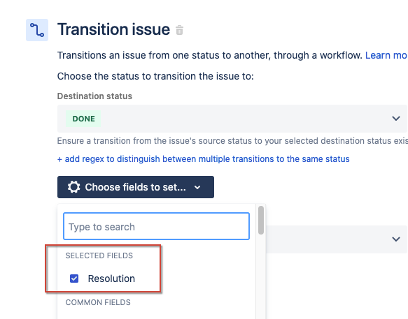

I'm 99% sure this is the problem:
Like • Guillermo likes this
Jonathan Le
May 10, 2021
Agreed, rather than not defining a resolution as my last image shows you should deselect Resolution from the option "Choose fields to set..."
Rex Parsons
June 5, 2025
Yes, this fixed the problem I was having. Once I unselected the resolution, it worked without error. Thanks.

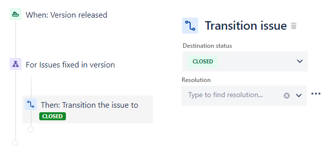

Spencer Hudson
September 10, 2026
A bit of an update in 2026 on this issue.    The problem is the same one , but the dialogue box has changed and the steps for the solution.
Your still looking to remove the "resolved" element ... in the screenshot below i've opened up the "more options" and removed the offending code.    :)
