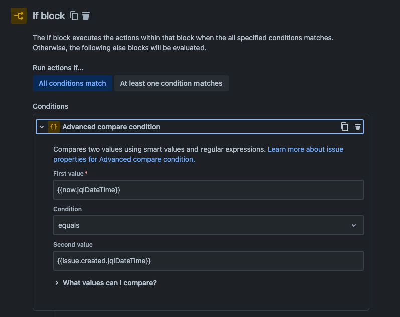

I stumbled upon similar problem where I wanted to run trigger Field value changed and then in subsequent if/else conditions check for whether the change in field value was during issue creation or update. I solved it by comparing dates for issue created vs. now. This could help in your use case @Sion Dinh.
This condition will run when change was made during issue creation:
You can verify that by logging action:
Note: the solution does not guarantee 100% accuracy. If Jira slows down for some reason and fires the automation rule more than a second after issue was created, it may fail. So to prevent that you can further consider comparing the two timestamps (now and created) by calculating the difference between them and setting acceptable delay, e.g. 5000 milliseconds (5 seconds). Use {{[date1].diff([date2]).[unit]}} to do that. More documentation here: https://support.atlassian.com/cloud-automation/docs/jira-smart-values-date-and-time/

Hi @Krzysztof Achinger
Such a rule could also run into problems when the automation engine is impacted, such as by an outage.  In this case, some rules will run at an indeterminate time in the future and some will not run at all.  (This has been confirmed by Atlassian staff in other community posts.)  There really is no way to know/guarantee when a rule will run, and so relying on {{now}} to decide if a create or update happened could be problematic.
Kind regards,
Bill
Indeed, that is what I described in a "note" after screenshots.
