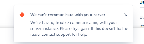

Hi ,
We are using confluence migration assistant app to migrate confluence form server to cloud & getting the below error while we try to initiate a migration. Any idea why this could be coming?
This is happening since we have upgrade our confluence to 7.4.1 recently. Please help

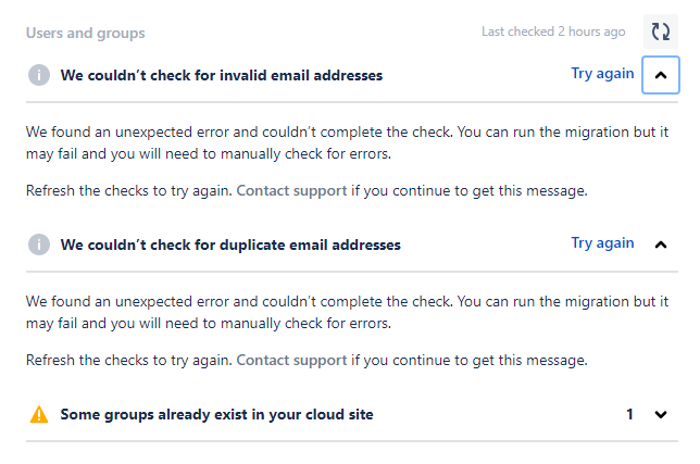

I have the exact same error in the pre-check of a Confluence migration:

I appear to have such errors/warnings in my logs:
2022-02-28 13:15:39,194 WARN [Caesium-1-1] [impl.schedule.caesium.JobRunnerWrapper] runJob Scheduled job migration-plugin:checks-runner.SharedEmails#ab72657c-997c-4c6a-9460-c4d8101ce3ab completed unsuccessfully with response JobRunnerResponse[runOutcome=FAILED,message='UncheckedExecutionException: org.springframework.dao.DataAccessResourceFailureException: PreparedStatementCallback; SQL [SELECT USERNAME, CREATOR, LASTMODIFIER
FROM NOTIFICATIONS
WHERE SPACEID = ? OR CONTENTID IN (SELECT CONTENTID FROM CONTENT WHERE SPACE']
2022-02-28 13:15:39,255 WARN [Caesium-1-1] [v2.c3p0.impl.NewPooledConnection] log [c3p0] A PooledConnection that has already signalled a Connection error is still in use!
-- checkExecutionId: ea2f40a97da7e362383b96f3374ca50214518277
2022-02-28 13:15:39,255 WARN [Caesium-1-1] [v2.c3p0.impl.NewPooledConnection] log [c3p0] Another error has occurred [ com.mysql.jdbc.exceptions.jdbc4.MySQLNonTransientConnectionException: No operations allowed after connection closed. ] which will not be reported to listeners!
Caused by: com.mysql.jdbc.exceptions.jdbc4.CommunicationsException: The last packet successfully received from the server was 464,996,117 milliseconds ago.
The last packet sent successfully to the server was 464,996,118 milliseconds ago. is longer than the server configured value of 'wait_timeout'.
You should consider either expiring and/or testing connection validity before use in your application, increasing the server configured values for client timeouts,
or using the Connector/J connection property 'autoReconnect=true' to avoid this problem.

 The Error trace starts with this:

Adding "&autoReconnect=true" to the jdbc-connection string solved the problem.
