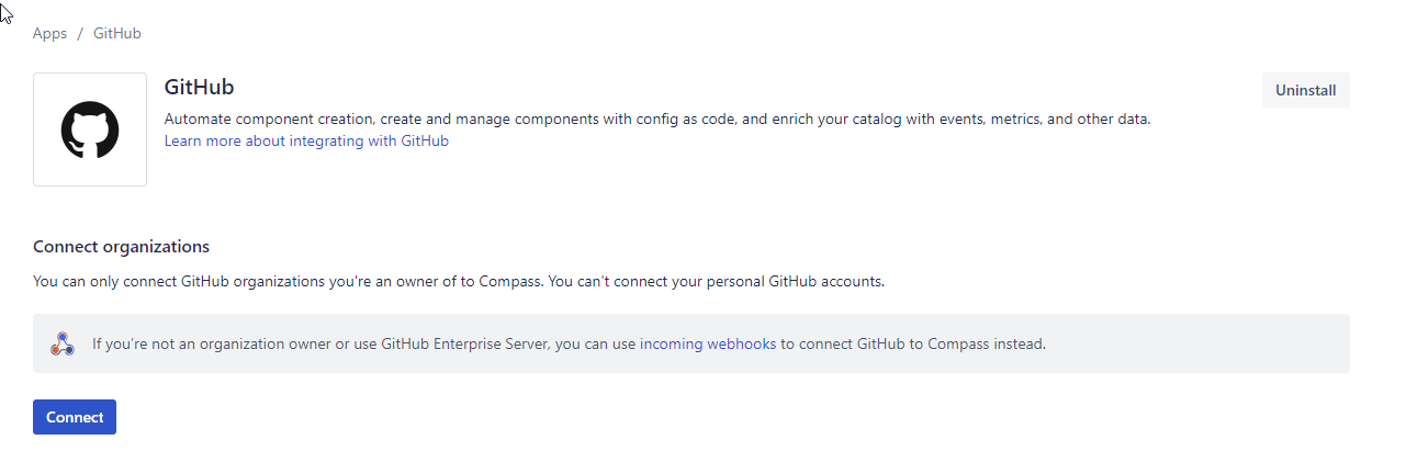

We run GitHub Enterprise Cloud and are trying to get Compass integrated.
I had an GitHub Enterprise owner set up as admin in Compass and had him install the GitHub App in Compass.
We walked through the steps and selected a specific repository instead of all repos, so that we can limit our evaluation in scope.
Once done, Compass does not provide any sort of indication of the integration was successful. If I check on the GitHub App page in Compass, I get a screen which doesn't seem to indicate that this was a success:
3 votes
Enrique Serrano Valle
March 5, 2024
@Ronny Katzenberger let's see if we can get this solved. The fact that you aren't seeing any connected workspace in the screenshot of the "Compass GitHub App" screen that you provided suggests that something didn't work as expected during the Compass - GitHub connection.
There's a specific situation where attempting to connect a GitHub organization when such organization already has a "GitHub Compass App" installed (that is, the "Compass" application already installed in "GitHub") that results in no successful installation and not a lot of visual feedback either.
For example, if in the screenshot below I selected any of the two organizations where the "GitHub Compass App" were already installed (that display the "Configure >" option), I would not be redirected back to the "Compass GitHub App" and Compass would not be connected successfully to GitHub. (If a Compass Admin and GitHub admin selected an organization that didn't have any "GitHub Compass App" installed - like the third row in the screenshot - the process should complete successfully.)

Is this something similar to the scenario that you encountered? If so, the following steps may help solve it:
  1. Uninstall the "GitHub Compass App" from GitHub. You'd find it in the https://github.com/organizations/your-organization-here/settings/installations section, and you can remove it in the "Configure" button related to the "Atlassian Compass" GitHub app.
  2. Have a Compass Admin (also being a GitHub Admin) configure the GitHub connection inside of Compass. When selecting the organization to connect, you would see just an arrow `>` instead of the `Configure >` option.
  3. Completing this should redirect you back to Compass once you select repositories and accept. (If there's no redirection back to Compass, something would still be missing.)
Please let me know whether the steps above helped, or whether we need to try something else.
Ronny Katzenberger

Ronny Katzenberger
March 7, 2024
Thanks for the tip @Enrique Serrano Valle - it looks like this was the issue and our team was able to get it working yesterday.
