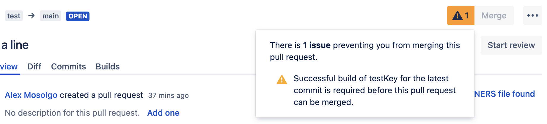

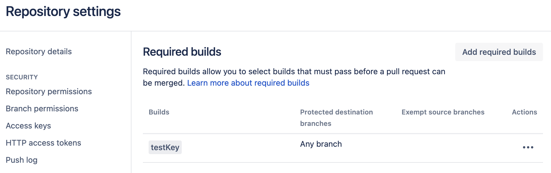

- Configure a required build for key "testKey":
- Confirmed the PR merge is blocked due to missing required build:

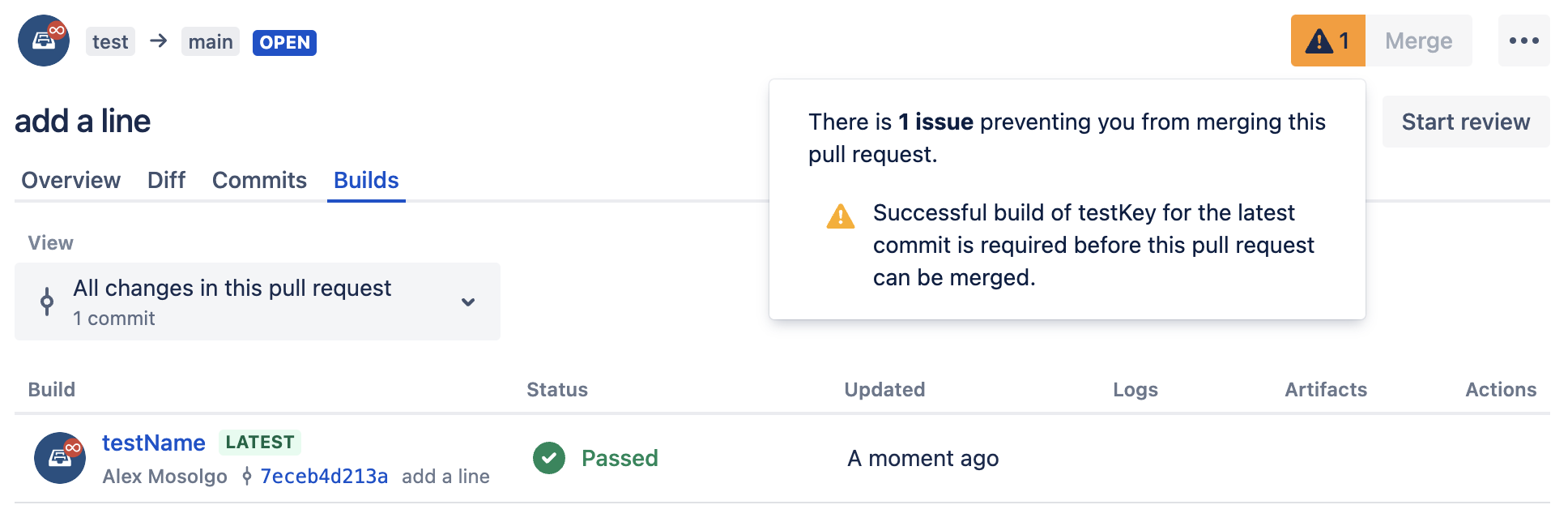

- Add a successful build to the latest commit via the REST API:
❌ The PR merge was still blocked due to missing required build:
- My expectation was that the required build merge check would pass after posting the successful build result with key "testKey".
- Confirmed the build with key "testKey" is listed as expected via the REST API:
