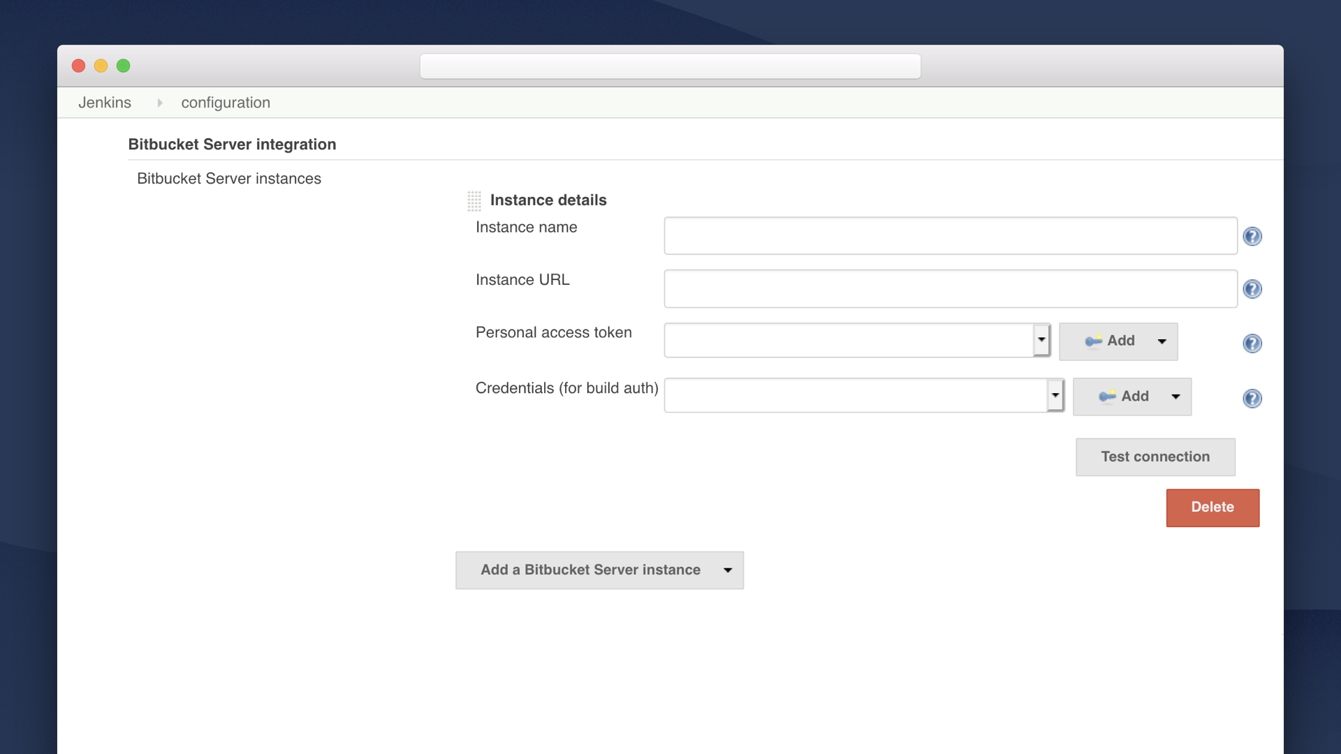

I have followed the instructions for setting up our Bitbucket Server instance in Jenkins and the personal access token for an admin user, but when testing the connection I get "Connection failure, please try again", despite having followed the instructions at stated without any apparent problem.
For the "Instance URL" I put verbatim what appears as "base URL" in the Server settings of our On Prem Data Center Bitbucket instance: https://bitbucket.our.domain:8443. From the same Jenkins machine, I have no trouble accessing this bitbucket instance over ssh to clone repos.
We are now running Bitbucket Server 7.2.3 and Jenkins 2.222.3, with Bitbucket Server Integration plugin 2.0.1.
I do not see any relevant information in our /var/log/jenkins/jenkins.log after this failed connection test.
Please provide any suggestions you have for troubleshooting this.

Hi @Tim Black , thanks for your comment. I'm afraid it's difficult to diagnose the issue without more information. You mention being able to clone with SSH locally, which may be the issue- the plugin only supports cloning by SSH from version 2.1.0 and above.
If you are still having issues, please file a ticket at https://issues.jenkins-ci.org/ with the component atlassian-bitbucket-server-integration-plugin.

My problem turned out to be caused by the fact that our bitbucket server was using a self-signed certificate. Once we got an external verified, trusted cert, the connection worked fine.

@Tim Blacksorry to gravedig, we happen to have the same type of setup (bitbucket + self-signed certificate), and are trying to integrate with jenkins via the bitbucket server plugin.
We are experiencing exactly the same type of problems.
Would you mind sharing (if there is more) details of what led to the conclusion about the self-signed certificate?

For the reference, after writing the above comment, I found the issue.
The OkHttp does absolutely the right thing, and validates the host name not on the CN (depreacted by RFC) but on the subjectAltName. Here is an example how to make a CSR :
https://blog.arkey.fr/2017/10/19/self-signed-certificates-in-java.en/
