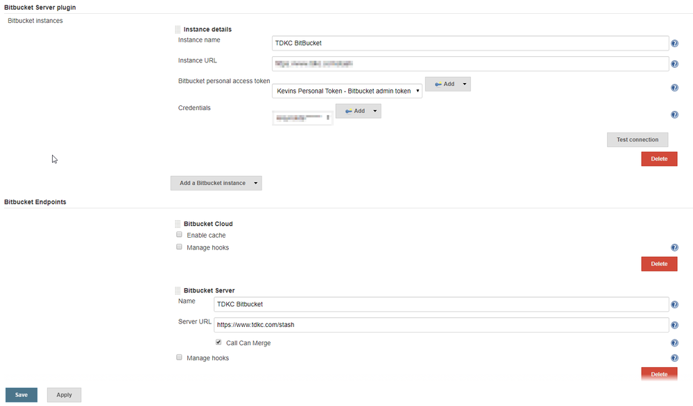

Adding a linked Bitbucket Server instance

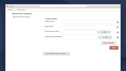

After installing the plugin you need to configure at least one Bitbucket Server instance. To do this:
  1. In Jenkins go to Jenkins > Manage Jenkins > Configure System
  2. Under Bitbucket Server plugin click Add a Bitbucket instance
  3. Enter the instance details

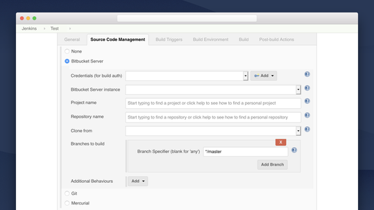

Configuring the Jenkins job

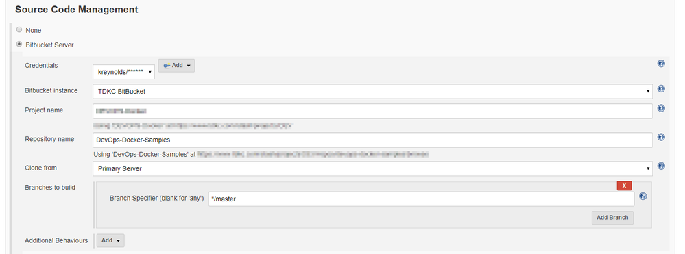

  1. Go to the Source Code Management section of the Jenkins freestyle job and select Bitbucket
  2. Select the existing credentials or add new to authenticate with Bitbucket Server. The credential should be of the type Username with password
  3. Select the Bitbucket instance
  4. Enter the project key and repository slug
  5. In the Build Triggers select Bitbucket Server trigger build after push
  6. Configure rest of your build steps and save the job
When a new push happens the build will be triggered. You can then check the build info in Jenkins to see the changeset.

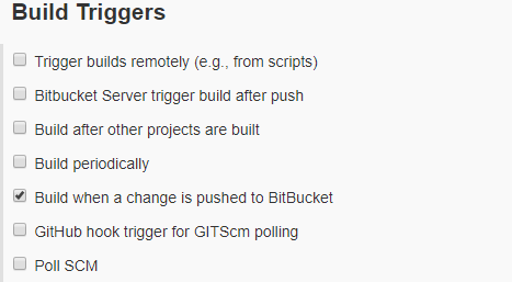

Kevin Reynolds October 1, 2019
Happy to post here for any others who my be facing similar.
Environment
BitBucket Server 6.6.2 running on Ubuntu 16.04 LTS
Jenkins 2.176.3 running in a docker container
Latest as of 9/30/2019 beta of the bitbucket addin for jenkins.

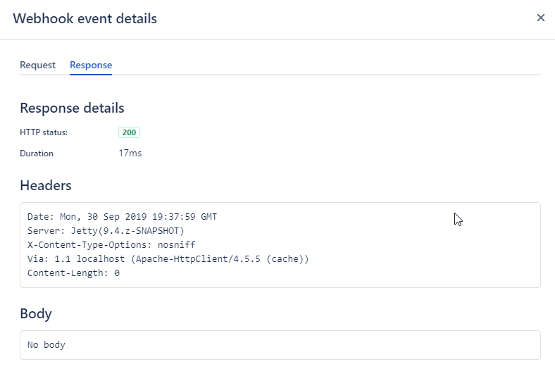

I believe I have all the bits and pieces for the server connectivity configured fine as a connection test works fine.

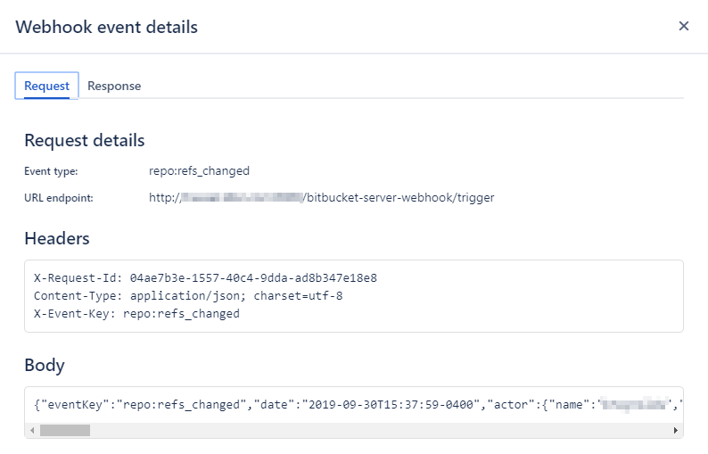

Create a webhook for when a push occurs.
Push code to my repo but nothing happens on the jenkins side.
If I examine the information for the hook it states a successful fire with a http status of 200
However looking at the response I see nothing in the body (not sure if there should be anything.)
A little confused as to where to go to look for potential problems as it looks like the the request was made correctly.  This should just work.  Please find attached some screen shots of the configuration.  sensitive information obfuscated.
One thing in the jenkins log is an error with mirroring but as I understand it thats a datacenter feature not a server feature?bitbuckerServerPlugin.pngbuildTriggers.pngsourceCodeManagement.pngrequest.pngresponse.png

Hi @Kevin Reynolds
It appears that you've selected the wrong trigger. You need to select "Bitbucket Server trigger build after push" to get the webhook created. The one that you've selected is not related to our plugin.
Regards,
Kristy
Gaurav Joshi
October 1, 2019
Hi @Kevin Reynolds
Please enable "Bitbucket Server trigger build after push" checkbox. The other setting "Build when changes are pushed to Bitbucket" belongs to a different plugin. This setting is necessary for the webhook callback to trigger the build on this project.
Also, ignore the Mirror handler exception. We will be fixing that in the subsequent release to not throw this exception. Your configuration should work properly. This exception has no effect on your configuration.
Also, from beta 1, you don't have to manually add webhooks to bitbucket server. The plugin does that for you provided the "Bitbucket Server trigger build after push" checkbox is enabled.
Thanks
Kevin Reynolds October 2, 2019
Awesome! Yes that was it.  thank you it now works flawlessly.   Really excited about this and happy that Atlassian dove in head first rather than the normal model of leave it up to the marketplace.  This is a core competency that should be out of the box with bitbucket.

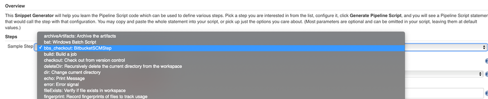

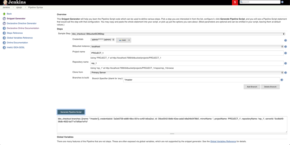

Hi @Kevin Reynolds
The snippet generator should have a bbs_checkout step in there:
You should then be able to fill out all the derails and generate the snippet for your Jenkinsfile
Hope that helps,
Kristy

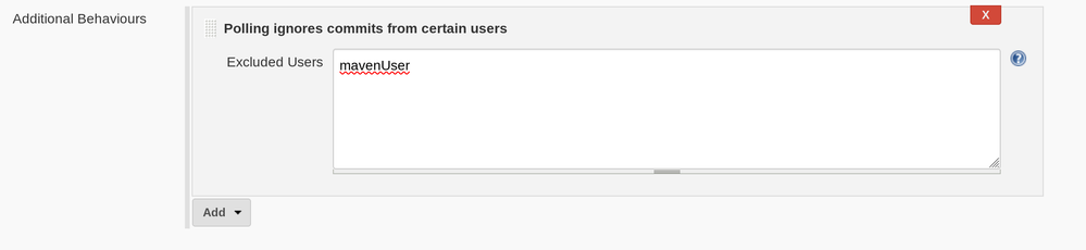

Thanks for explaining. I have created a suggestion here - https://jira.atlassian.com/browse/BSERV-12043. Please vote/watch this issue to follow the updates.
As a workaround, can you try adding 'Excluded Users' from 'Additional Behaviours' without any other changes to your config? Hope this helps. image.png

Sake
November 7, 2019
@Imran Khan Thanks for creating the item, it would be a good addition to Bitbucket! The workaround might look like what our users want in the meantime, thank you! Maybe document it?
