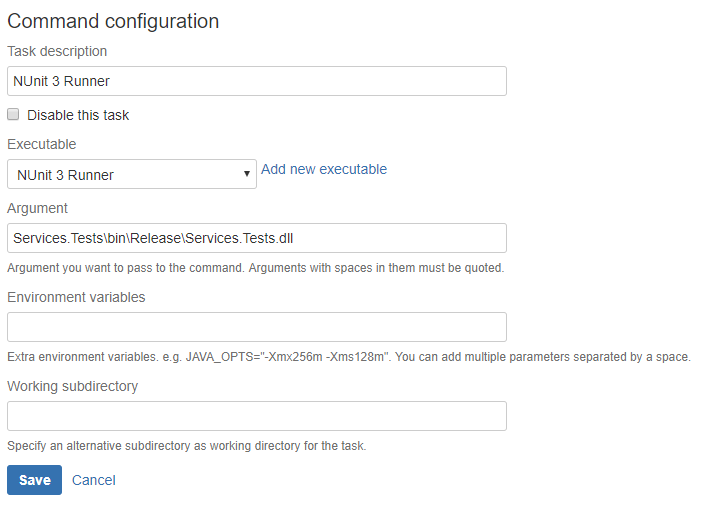

And in the build plan I have the following in the Command task:
And the Services.Tests DLL i reference above also exists in the bin\Release folder so it's not that the DLL is missing.
